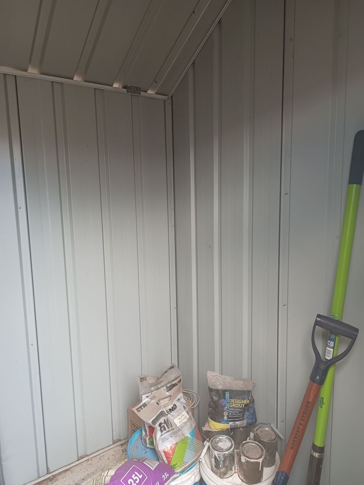

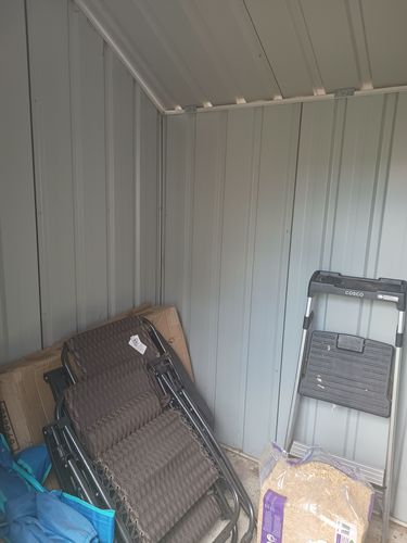

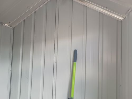

I am looking to hang up frames (Various sizes from small to large A1 poster frames) within my shed, however I am not sure what would be the best way to do this.
I had thought about installing some vertical and horizontal timber and covering with boarding, however there are not any corner posts to attach the framing to.
What would your recommendation be to hanging frames and the best approach.
Thanks for your help and suggestions.

Shed walls can be tricky for hanging items like frames since they’re typically made of thin metal that doesn’t provide much support for fixing objects. However, there are a few approaches you could consider. If you want to hang multiple frames securely, creating a timber framework within the shed is a good solution. Although you’ve mentioned that there aren’t corner posts to attach the timber to, you can anchor vertical battens to the shed’s metal frame or floor using metal brackets or strapping. Once the vertical supports are in place, you can add horizontal battens and cover the framework with plywood or panel board, creating a solid surface for mounting your frames with screws or picture hooks.
Alternatively, if you’re looking for a simpler option, Shed walls can be tricky for hanging items like frames since they’re typically made of thin metal that doesn’t provide much support for fixing heavier objects. However, there are a few approaches you could consider. If you want to hang multiple frames securely, creating a timber framework within the shed is a good solution. Although you’ve mentioned that there aren’t corner posts to attach the timber to, you can anchor vertical battens to the shed’s metal frame or floor using metal brackets or strapping. Once the vertical supports are in place, you can add horizontal battens and cover the framework with plywood or panel board, creating a solid surface for mounting your frames with screws or picture hooks.
Alternatively, if you’re looking for a simpler option, heavy-duty adhesive hooks or strips might work well. Many are designed to stick to metal surfaces and can hold a surprising amount of weight, making them a great non-invasive solution for lighter frames. However, they might not be suitable for larger or heavier items, so it’s essential to check the weight limits.
Both methods have their advantages, and your choice will depend on how permanent and secure you want the setup to be.

Just a couple of tips when using the adhesive ones. Make sure the surface is very clean and dry. But the main consideration is heat, which affects the adhesive to stay long term. If the shed wall is exposed to direct hot sun, they will soften and drop off.
