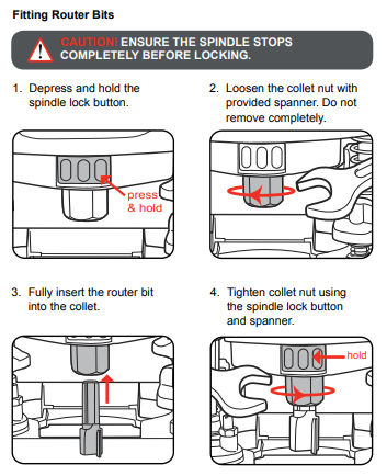

$99 corded. Burr in the collar.not letting shank in. Small file.

I can only refer you to the router bit installation instructions. The spindle lock button must be depressed in order to turn the collet nut and once the bit has been inserted it must be kept in place while the spindle lock button is pressed again to tighten the collet nut. If after several attempts the router bit will not sit in place, I recommend bringing the tool back along with your docket to the store where you purchased it from and showing the senior tool specialist what is happening. Once the tool specialist has examined the tool, they will make a determination if it is defective and needs to be exchanged.
