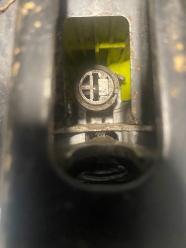

great difficulty inserting blade into saw despite doing it a number of previous times. Pin doesn’t appear to move and just how far should the lock/unlock lever move?

Could you let me know the model number of your reciprocating saw? A quick photo of the blade locking mechanism would also help.
The lever on reciprocating saws is designed to move only a short distance, usually about a quarter turn. When you rotate it to unlock, the internal pin should retract slightly, creating enough space to slide the blade’s shank into the clamp. If the pin isn’t moving, it could be due to debris, wear, or the lever not being fully rotated.
A couple of things to check: first, make sure the saw is unplugged or the battery is removed for safety. Then, gently work the lever back and forth to see how far it will travel; don’t force it, but it should move enough to clearly click into the unlock position.

The model no is R18RS and I’ve attached a couple of photos. The lock/unlock lever can only travel a short distance as it butts up against a metal? part which you sort of can see in the upper left of the photo. Not sure whether the lock lever is supposed to push that down to let the pin slide.

Thank you for the photos.
Has the handle broken off?
You can see in How to fit A blade to a RYOBI Reciprocating Saw that there is usually a much larger handle for you to rotate. It may just be the photo, but it seems like there's no handle there.
If this is the case, you might be able to use some pliers to help rotate the mechanism.
