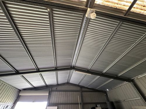

Appreciate any insights on retrofitting
foil board to shed ceiling.  There are surprisingly few reputable sources of information on this and the foil board illustrations leave much to be desired.
From the description the https://www.bunnings.com.au/foilboard-flexifast-fasteners-400-pack_p0131086 are what I need for attaching to the top hats - but I just don’t see how this would work, as the top hats have a lip on them for strength, which will make installing these clips a real challenge.
I’m just not seeing how this works without installing some other kind of bracket - but then that presents a challenge in itself, on what is needed there to attach to the top hats.
Any suggestions on what is needed here?   Keen for help with steel shed insulation board retrofit instructions, photos or alternatives.
Sincere thanks for the help!

Thanks so much @EricL appreciate the help. With attaching the timber strips, do you mean drilling them onto one of the two thin edges of the top hat?
I suppose too I’m not saying they don’t work just more wondering how those fixings are supposed to work with top hats as the description says they can - I just don’t see how as yet!

I propose drilling them into the side of the top hat not the thin edge. The timber strip must be secure so that they don't move and can hold the Foilboard steady. If the top hat was in reverse with the wide flat end exposed, you could drill into it. If the edge of the top hat was wide enough and strong enough you might be able to screw into it. However, if it is not secure enough it might just split the edge of the top hat edge rendering the fitting useless.
If you can access the top hat or have a sample piece you can look at, you'll be able to tell straight away if the edge can be drilled into and if it will be secure enough.
