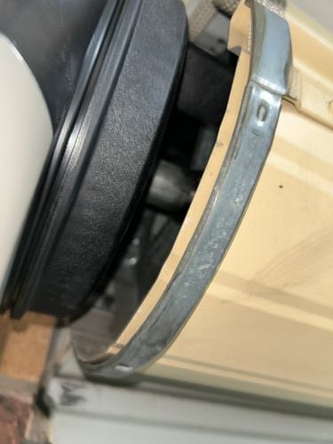

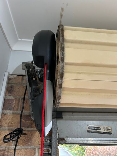

Having issue with Motor spoke straddling FULLY into drum. Spoke are at the edge of the drum slot and unit is not close to the curtain, please could you see photos and advise how do I fix the issue?
Currently opening and closing the door manually, can see spokes on the unit rotating fine but I am not convinced unit engaged into drum 100%.

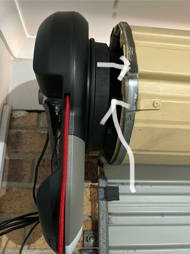

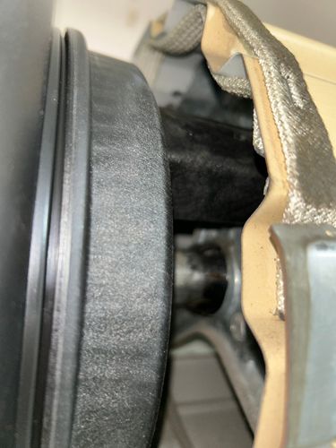

Thank you for getting back on this, much appreciated. I did pull the rope to have the unit in manual operation before I installed. After installation, when I close and open garage door manually I can see that spokes turning along with the curtain in circles.
Spokes are just 5% to 10% into drum. Also unit is not close to drum, as I marked up with white arrows, unit black cylinder should go inside the drum but now there is some gap.

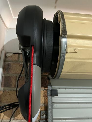

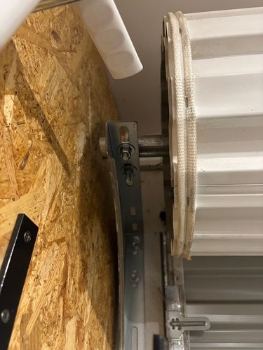

From your last photo @Newbie450 it appears you have not located the motor close enough to the roller drum, roughly 50-70mm. Below are photos I have just taken from my rear garage roller door motor I installed. My motor is on the right side not that that matters. It appears to me that your left wall brackets is too far away from the roller.
But as @EricL mentioned, I would be referring to the installation manual, then if your still struggling contact the motor manufacture directly as a far faster way of getting the correct information.

Thank you for sharing that. I will remove the unit and try re-insert. Unit forks are just not sliding into the drum slot fully, only went in about 5%. You are correct on what I meant by spokes!
Drum slot metal measured about 5cms and gap between unit forks is about 5.5cms, should just slide in but not!

 I had another go at re-inserting HomeEntry unit and succeeded this time. Had a friend to lift the curtain and I pushed it in, it slided in easy.
All set, programmed and tested, working like a charm (photos attached!).
