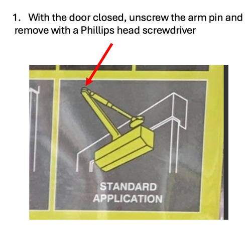

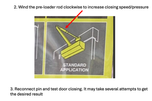

The "preload" adjustment is what set's the closing pressure/speed in order for the door to close and self-latch. You may have done this before with a screen door closer, where the preload is adjusted via a screw at the back.
These are the steps for the style of closer you are considering:
Hope this helped. Regards Nailbag
