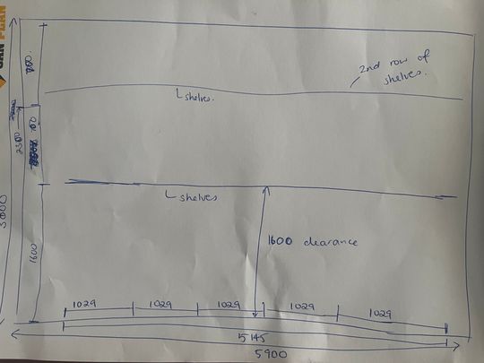

I want 2 rows of shelving that are wall mounted. I want it to have a heavy load bearing. I would like to have a 1600 clearance from the floor and then two rows above that. See diagram below.

Then I'd suggest the easiest and most heavy-duty option would be to install stayed brackets at the required height and fix melamine panels onto them for the shelves. Here's a helpful guide: How to drill into bricks.
