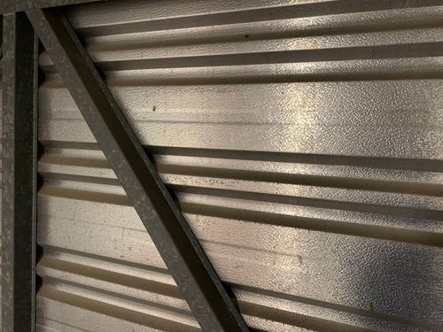

The metal frame around the outside edges of the door are open, creating a natural home for the insulation bats:
And I assume the method is to cut the individual batts to the correct shape and size so as to butt up against the solid metal frames in the middle, ensuring the whole thing sits flush with the existing depth of the metal frame:

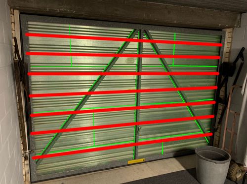

So once the batts have been cut to size and shape (marked in GREEN in the below diagram) the strapping (marked in RED) should run horizontally across the entire thing like so?
How would I go about installing the strapping onto the existing metal frames?
And would I then put the cover over the top of the entire thing?
Thanks!
That appears to be @EricL's general plan @OneMansFool.
The strapping could be screwed to the top and bottom rails with self-tapping screws. You might like to screw it to the top rails and wrap it under the bottom rail. Have a helper outside the door pull it tight whilst you screw it off to the bottom rail. The cover would then go over the entire inside of the door.
