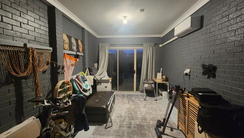

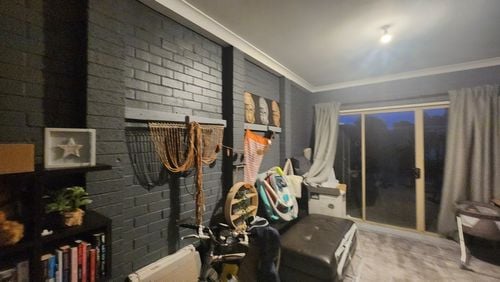

Hello, looking to convert my cold brick garage to a playroom. Looking for cost effective and easy recommendations for insulating the walls? Could I work with the shape of the wall and just place foam boards inbetween the raised bricks? Do i need a gap? Do i need battons etc? Any help appreciated

I propose having a quick look at this featured project - Garage converted into home library by @Dave-1. It has heaps of great ideas, and its conversion was very well thought out. As for your brick wall, I propose building a timber batten frame and anchoring it to your brick wall. The timber batten can then hold the insulation in place, and you can line the timber frame with your preferred cover.
Here is a great example of the walls getting framed up - Garage lining for stud walls stage 1 by @Dave-1. Here is part two - Garage lining for stud walls stage 2 (Cornice and skirting boards). This would be the most effective long-term way to insulate the room.

Thats a nice space to work with, I was goingto post the links to my garage retrofit but then read @EricL's words lol
Definently you could have the false stud walls with insulation and then plaster straight over the lot and straight past your brick supports. (Note that garage floors tend to have a slope to them so it wont be square.
For the other wall I was thinking of Prempanel 2700 x 600 x 21mm Oak Timber Acoustic Panel and probarly install four thin horizontal slats along that wall to connect the panels to. brick walls I have found might look straight but arnt always and the slats will help give a uniform surface. I wouldnt have the panels resting on the ground for the same reaon i wouldnt have the plaster on the ground, maybe 20mm off just so moisture cant travel upwrads as easily.
