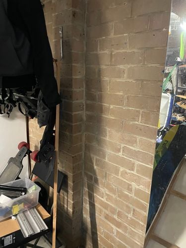

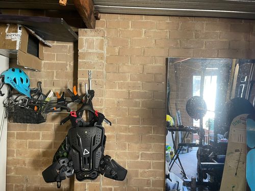

I’m keen to make this garage space more comfortable by insulating. I’m thinking of foilboard insulation for the garage door and roof.
What I am struggling with is what to do with the walls. The walls have an additional layer of bricks, (pillars), where the beams that support the roof are. There are 5 of these pillar every 1.8M on both sides.
I was thinking of building frames and attaching them between these brick pillars and adding wall insulation only between these pillars. I was just going to have only plywood over the pillars. Will this actually make any difference to the climate inside the garage?
I lose too much space if I insulate over the brick pillars.
Another question, do I new to put sarking on the brick wall before putting the frame up and installing the wall batts?
I would greatly appreciate any advice.
