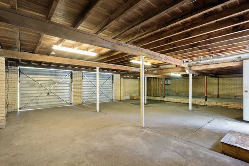

Hi. I want to insulate my garage which is under my house. The house i am living in built in 1975.  The location is on very busy road. I want to suppress noise and also want to cover with any sheet. I need some helpful tips. How to start and what kind of product should i buy for insulate my house and what is best to cover after it. I am very new and trying to solve a problem for my little family. I saw someone commented that i should check with local council. I live in Logan council and i didn't find any information on there website. It will be helpful if someone take me through to the information. I have attached few pictures for community people
 Actual floor
 garage ceiling.
 garage is underneath the actual house

Welcome to the Bunnings Workshop community @umairayub. It's brilliant to have you join us, and many thanks for your question about insulating your garage.
So our members know exactly what your project entails, could you tell us a little more about insulating the floor? Do you suspect this road noise predominantly comes through the floor directly over the garage? What rooms in the house are affected by this road noise? Is this noise mainly in the daytime or at night?
Given the garage area has brick walls, the road noise would most easily travel through the garage doors. It might be more effective to try and seal them than insulating the whole floor. Consideration should also be given to the windows on the property. Replacing the current windows with double-glazed options would be the most efficient way of stopping noise transfer through them.
If there are other factors to insulating the floor apart from sound, like controlling temperature within the dwelling, then this would be a project that improves the livability of your home. I'd encourage you to have a look at this helpful step-by-step article: How to install underfloor insulation batts. Once you've insulated the floor, you could certainly cover the garage roof with plasterboard.
Regarding council approval, I can't see why that would be necessary. However, it's always best to check, and you'll typically find that giving them a call is the most direct way to access information.

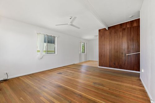

This image is for my living area and i have timber floor. Basically there is no sub floor.
Actually, heat is also a concerned. The garage cover the whole house. The noise during the day time when traffic get busier. I have a timber floor and there is no sub floor in between garage ceiling and my actual floor. My next project is to insulate the house internal wall. I appreciate your comment and will follow the guide. Thanks

Would you recommend which insulation product should i use to Cover garage ceiling as well as underfloor house. Since the garage is underneath the house. I need a product which is suitable for both purpose. Thanks
Re: under house garage insulation and cover
I apologise, @umairayub; I intended to link a product for you.
These Earthwool SoundSheild insulation batts will not only assist with blocking sound transfer into your dwelling but also help with the heat. They are suitable for use above your garage and below your floor.
