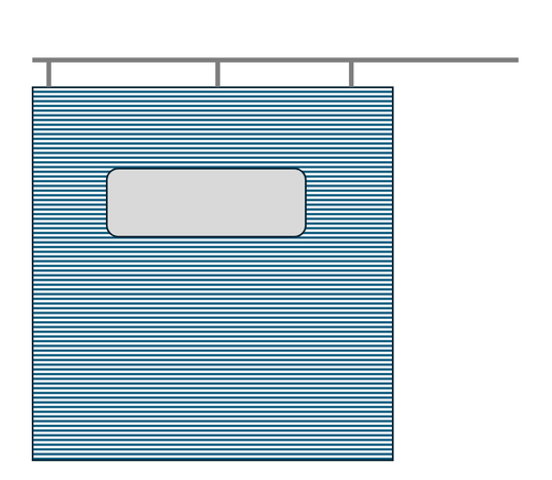

Hi @spike05
as well as both @JacobZ and @JoeAzza suggestions, mine is on the same track as @Dave-1 having a raised roofline above the outdoor room. Both the airflow and shade will have a significant difference in insulation and also keeping noise down from rain.
