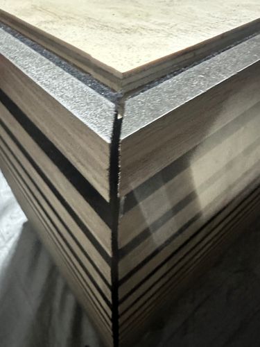

I’m trying to join some prempanel timber  acoustic panels together on a 90. I’ve cut them at a 45 but am wondering what would be the best way to fix the individual slats in addition with glue. Each slat is roughly 20mm

my question I think is more could I use something in addition with the glue to join them , pins, nails , biscuits ect. Wondering hat would be best given their small size

Does the mitre actually join or do you need to fill the void as the photo shows about a 5-6mm gap?

The mitre will join, the plan is to make it look seamless. I’ve just got them sitting together like that for illustration purposes.
I think it is a plastic with a veneer so am also wondering what would be the most suited glue

Is this the first one you have made or its the only one? If you are making more I would suggest to change your cutting lengths.
If this is the only one then I am thinking glue and biscuits or chamfers cut to size to fill the gap.
Any chance of a wider shot :smile: or a further back one as your project looks interesting :smile:

@Nailbag brings up a good point. Will the corners actually meet up or do you need to fill it? I'm a little bit hesitant to suggest biscuits or nails as the pieces are quite small and it might crack the panel edges. In this particular instance, I can only suggest a heavy-duty adhesive.

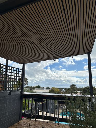

if they are those sound deadening panels then they are a soft timber wrapped with a wood look vinyl on a thick padded mat. They really are only designed to go flat on a wall butt joined. But I would use a high-grade wood glue and then tap in a long thin brad through each strip and fill in the head. They need a lot of support as thy are not very structurally sound at all. I used them on an outdoor deck ceiling and they took a lot of effort to join them and keep them there.

:smile: hahahahah Whoops, my description may have misslead. When I say "biscuits" I dont mean into the two corners but slipped between the to cut edges lik a wafer. Its to fill the space not actually go into each side of the panel.

Thank you so much for the clarification! If that is the situation then cutting up biscuits into square inserts would be one way to fill the gaps of the Prempanel. I also suggest using 3mm plywood, but it would require more effort to cut the large panel into small square shapes.
