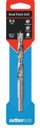

Hi @Zachary
as an alternative drill bit to the one @JacobZ recommended is a Sutton 9.5mm Brad Point wood drill bit. These make very clean holes for dowelling projects. Unfortunately I can't see this size/type on the Bunnings web site.

That would likely be a Special Order item from Sutton's extended range @Nailbag.
