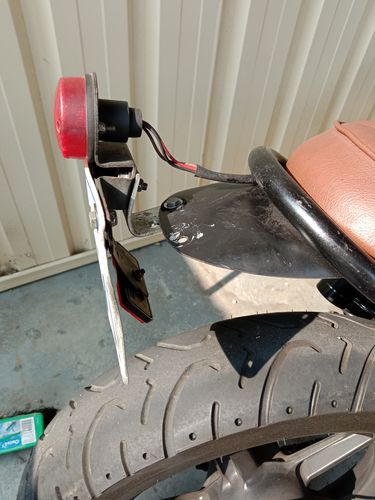

Hi there i would to build an L shaped motorcycle tail bracket but i don't have any tools.
It has to be a rectangular L shaped one,also i wouldn't know which metal to use.

Thank you for sharing your question about making a bracket for your tail light. Would it be possible for you to post a photo of the tail light and where you'll be attaching it to the motorcycle? This will give our members a chance to assess its location. We can then make recommendations on how to proceed.

Alumunium would work but hard to get a large angle piece. Painted steel is also good from a hardware store it is possible to buy 2 angle brackets.

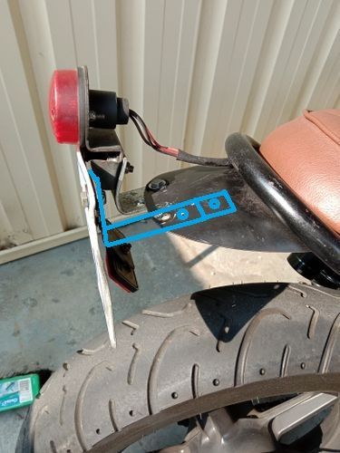

Looking at your photos maybe a single angle bracket could be used to support your existing setup.
You will need to check this hardware solution works for you as I cant tell strickly from photos.
The main issue would be the curve of the mud guard fitting the curve of the hose hanger It must be close to work,
