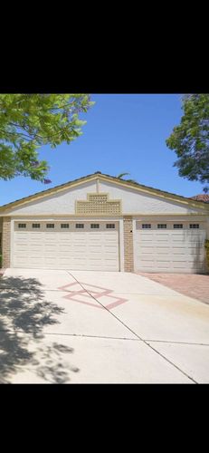

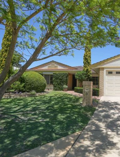

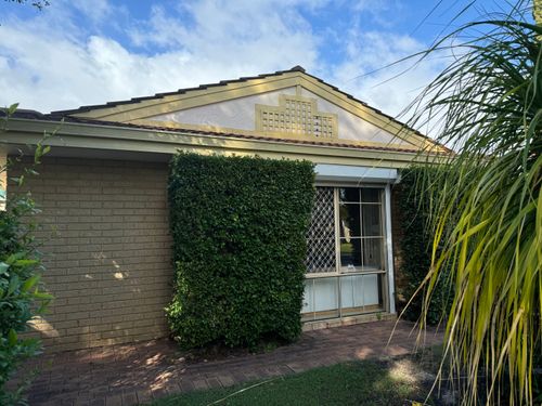

im looking at modernising the curb appeal on my house and wanted to update this.
thinking about putting in some vertical or horizontal cladding as I’ll be getting the roof done and looking to paint garage and all.
I haven’t looked behind here yet to see where the battens are but does
anybody have experience and advice on how to do.
I’ve also added some inspiration photos of ideas I came across. Thanks in advance. Cheers

at the moment it has that rendered cement look cladding.
roof ether manor red, wallaby or woodland grey but I do like the classic red roof. I think it was manor red originally so I’d like to keep it with that.
I’ll be putting in black double glazed windows for the front too so yeah kinda changing the lot. Will paint garter, gutters, cladding , trim and facia with matching colours with the roof.

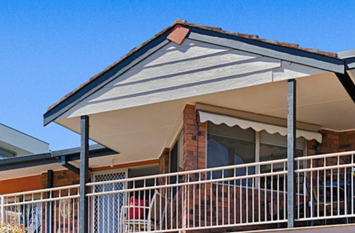

Hi @FitzyAdam I think the ideas @JacobZ has given is a great start. It really comes down to personal taste and what fits within the style of the house. Google searching "House Gable images" and checking other homes within your area of similar styles is always a great start. Personally I would keep it simple and clean. Your gable is quite shallow, so even updating the colours can make a huge difference. Ignoring the change of wall under the roofline, below is my last house and you can see the difference it made with untextured boards and a fresh coat of new colours to the gable.
Nailbag
Before
After
