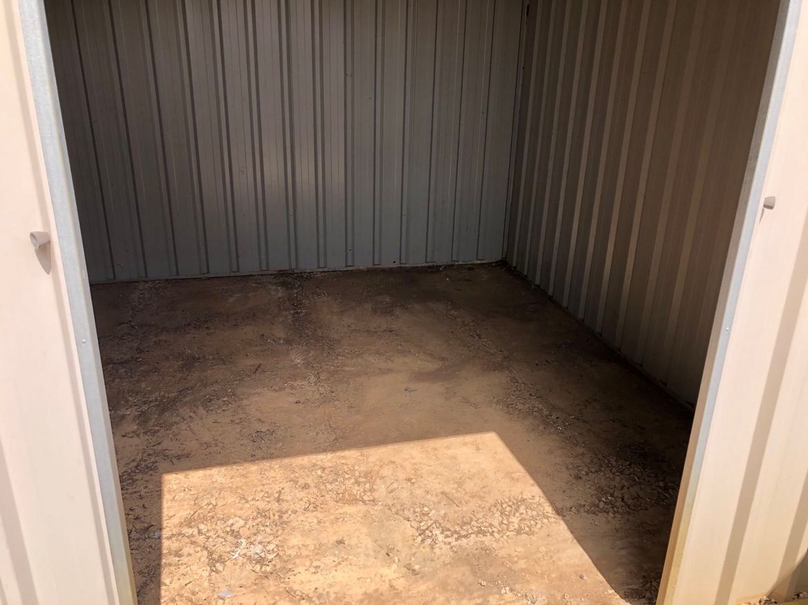

Recently moved into a place where had an existing 3x3m garden shed, the floor seems was concrete but not even, and had some old pallets on top. Wanted to seek your advise on what options are the most practical ones for a newbie who has very little D.I.Y experience (and tools) please:
The only purpose for this shed is for storage, and it is a bit hard to access.

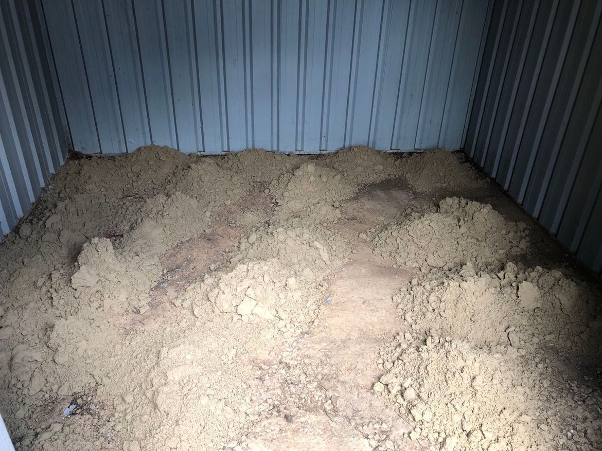

Add Bedding Sand

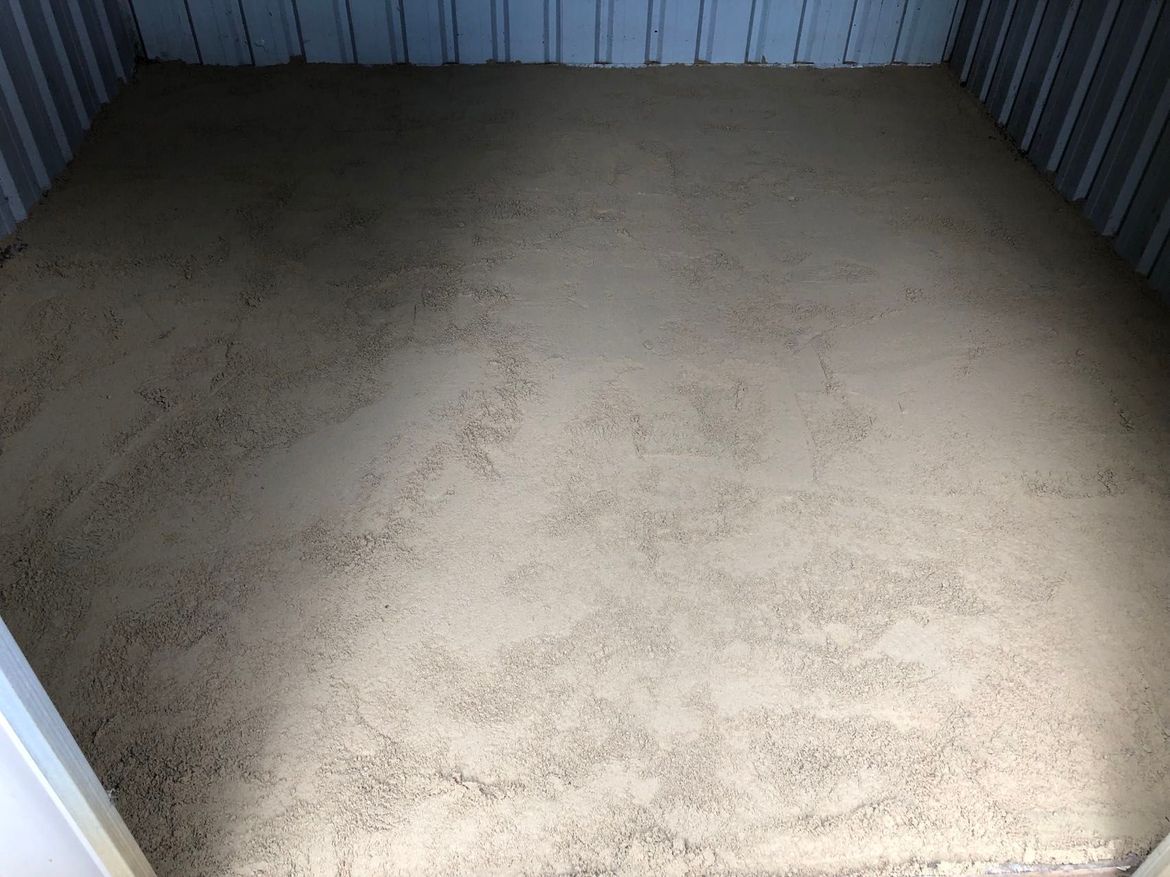

Basic Leveling

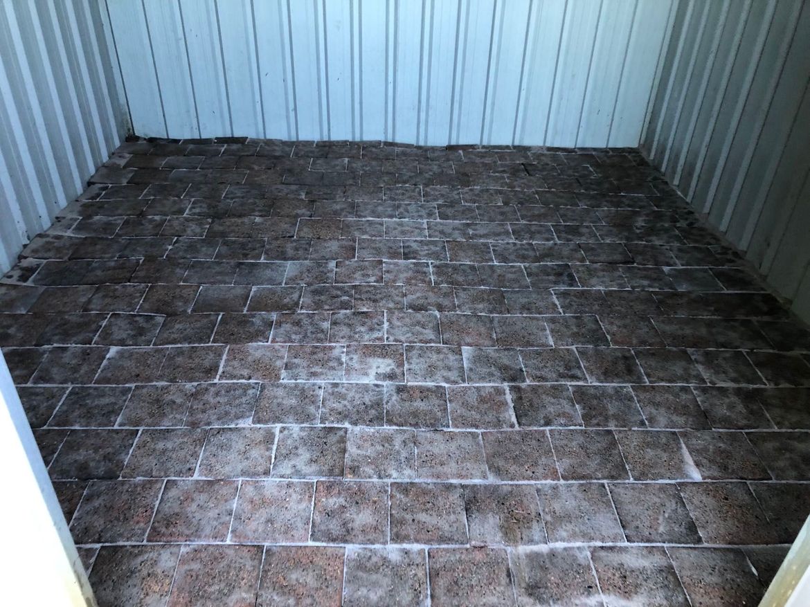

Add Pavers
Filled the paver mix sand
Lessons Learned:
1. Half a ton of sand (to cover 9 sqm) and the required pavers are not easy to be moved around with difficult access to the shed;
2. Once exhausted with moving the materials, I've ended up lost my patience to do a proper levelling, hope I won't regret too much later on;
3. Did not sweep off all the paving sand from top of the pavers before watering it, left some white marks and harder to remove.
