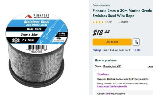

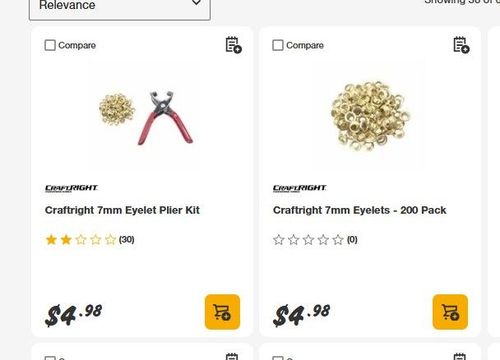

Re: How can I reduce the heat and light from my carport that has polycarbonate roofing?
Hi @ihocking,
Been waiting for responses to come in and I would like to add a couple of suggestions.
Retractable Shade Sail.
You could DIY with shade cloth plus...
The above.
Cheers
Looks like a good option. I will need to check with my local store as it says it is unavailable there. Thanks.
