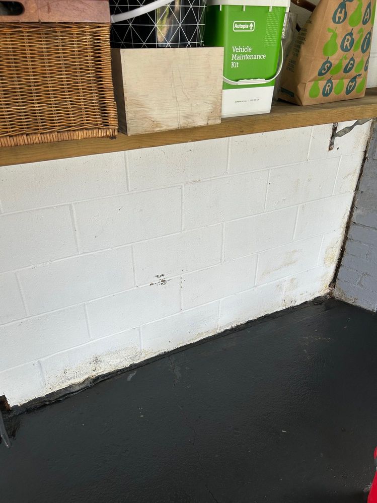

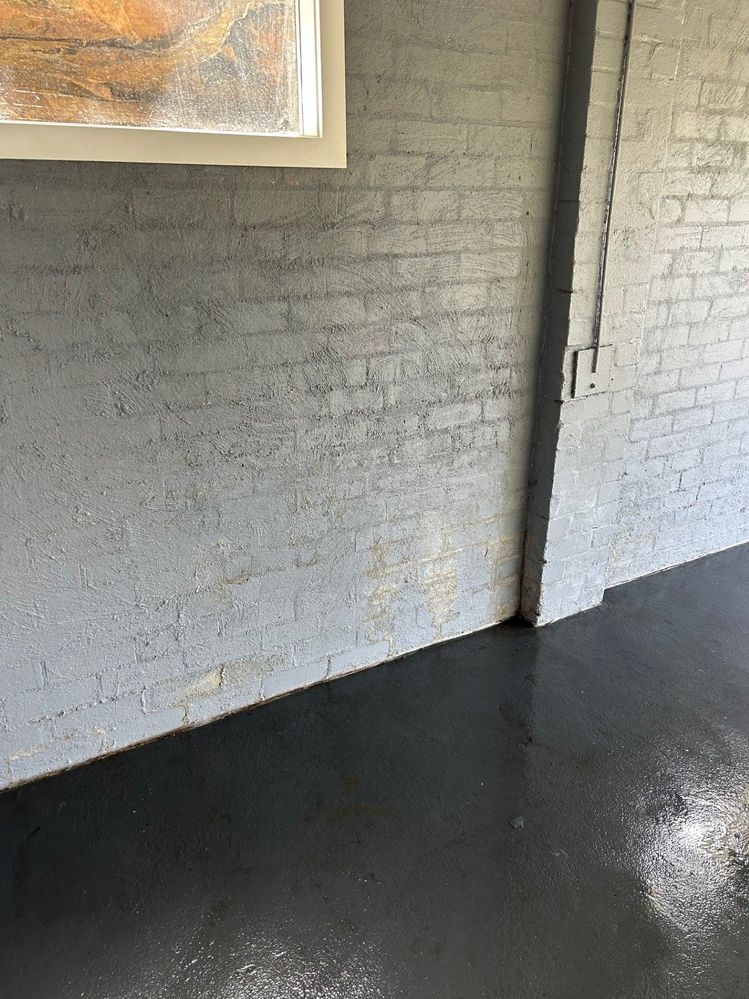

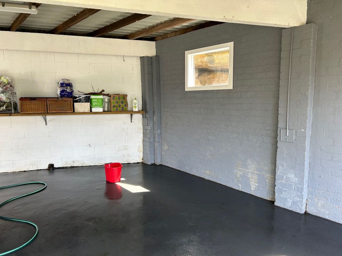

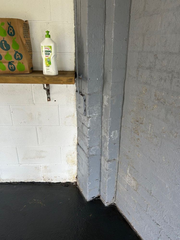

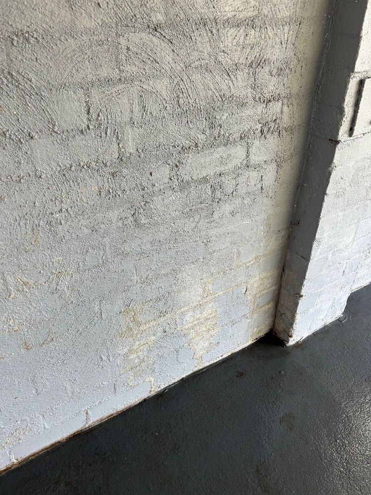

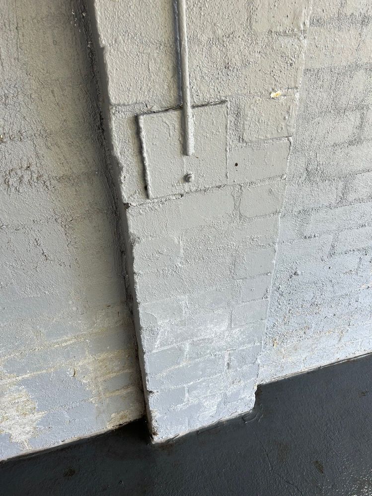

Hi all,
I have some efflorescence that has come up on the walls and ground in my garage.
I tried removing it with a high-pressure hose today, however it took the paint off (which I'm trying to avoid).
I then tried scrubbing it for ages with soapy water and a bit of white vinegar. That helped a little, but the vast majority of it didn't come off.
Any ideas for removing this without taking the paint off?
Thanksthumbnail_IMG_7867.jpgthumbnail_IMG_7861.jpgthumbnail_IMG_7862.jpgthumbnail_IMG_7863.jpgthumbnail_IMG_7864.jpgthumbnail_IMG_7865.jpgthumbnail_IMG_7866.jpg

Hello @PhilM1
Having had a second look at your pictures, it appears that you might have moisture coming through the wall which is often caused by hydrostatic pressure. Is this wall by any chance low into the ground or is the soil outside this wall higher than the floor on the inside? If so, then odds are water is settling inside the masonry wall and is making its way through it causing efflorescence.
Another possible cause is faulty plumbing or drainage along the outside wall. Again, water is making its way through the masonry wall and causing efflorescence. Generally speaking, if the water is coming from the other side of the wall the common repair applied is to dig into the soil and expose the wall. It's then sealed with a waterproof sealer such as Gripset Betta 1L Waterproofing Membrane Bitumen Rubber
If it is a plumbing fault, then the source of the water must be traced back to its source and repaired. In this particular instance, I propose engaging the services of a licensed plumber or a Leak detection/Water proofing specialist to investigate the cause of the overabundance of the efflorescence.

Thank you very much for that Eric!
Yes, there is elevated dirt on two of the walls which is likely leading to the accumulation of water. I'll see if I can find a water proofing specialist.
