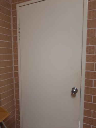

Hey Bunnings community! I'm working on a project to replace this external door within my garage: 

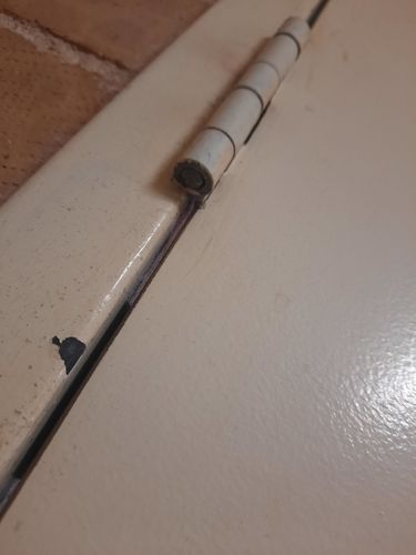

In order to do this, I need to remove the hinge pin, but the pin has this design:
What would be the best method to remove this hinge pin?

If you are tapping the hinge pin from the bottom, I propose spraying the hinge with WD40 while tapping it with a hammer. This is to allow the WD40 to penetrate into the rusted gaps of the hinge set. Once the hinge is fully soaked you can then give the hinge pin a go and see if it will come out of the assembly. If it is still stuck, I suggest getting a paper towel and spraying it with WD40 and hanging it on the hinge to soak. After 30 minutes make another attempt at removing the hinge pin.
Can you please tell us a little bit more about the hinge set. Is it welded on to the metal door frame or is it just screwed into place?

As garage door frames are made of metal Its highly likely this is not a loose-pin hinge @Samc2000 which means it can't be punched out from the bottom through and out the top. Photos of the hinges with the door open from the side and top will help determine this.
If it is a loose pin then you will need to use a long reach punch to tap the pin up and out. Using some WD40 as @EricL suggests will help with this. If it doesn't tap up then it will be a fixed pin and the hinge screws will need to be removed. Often the frame side of the hinge will be concealed behind the frame. Again more photos will help.
