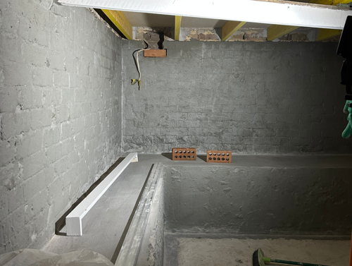

I am in the process of repurpose my basement storeroom into a study room (size 3000mm x 3600mm). I have removed the old render and applied a waterproofing membrane to the walls as the original wall was damaged by rising damp (see below).
I now like to render and paint the wall and like to seek recommendation on the followings:
- To level the wall, I'd plan to apply cement render over the waterproof membrane so it can be made smooth for painting. Like to know what type of render can I apply over a waterproof membrane.
- Is there a need to apply a primer over the waterproof membrane to improve the adhesion of the render? If so, what primer should I be using?
- As the wall was very rough and uneven (i.e. there are areas which are off by ~30mm), I'd think it needs a two or more coats of render to make it level/smooth. In this case, should I be using a different render for the base coat and the finish coat?
