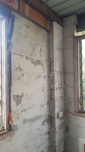

- The two louvered windows are set in rotten wooden frames. The panes don't fit together well, have cracks and there are plenty of gaps in and around the frame / slats. A lot of dust & dirt must travel through.

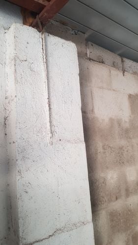

- In some parts of the garage, the walls (built with concrete blocks) don't reach all the way to the roof so there's a gap (again, perfect for dust & dirt to come inside).

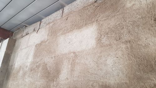

- There are other smaller gaps in the brickwork, all at the top of the walls where they should really join the roof without any gaps.

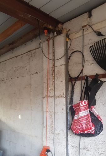

- Electrics are dated and built up of daisy chaining extension cords. Needs updated by an electrician.
- The walls are made of concrete with paint peeling off.

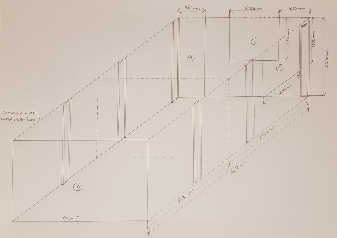

- Insulate and update the walls. These seems quite 'straightforward' in that I feel I need to attach timber frames to the existing walls, insulate the cavity and cover with gyprock. I'd need to plan around the door frame, and existing windows, electrics.
- While building the frames, I envisage making sure there is a stud that lines up with the half way mark in the garage so that I can use this to attach a partition wall. The floor is concrete and so I'd need to secure the bottom to that. I haven't thought about how to attach it to the roof just yet.
- The front half of the garage with the roller door entrance (and no windows) will be the storage half. I think once the gaps are filled, and walls complete, this is the easier to paint and prep for use (excluding the roof issue).
- The back half of the garage (with the single door, and two windows) will be the gym half. This is the tricker half to update. I want to seal up one window which is really not needed. I want to retain the other window but replace the frame and glass. I need to replace the back door (which will be the entrance / exit into the gym half) and reinforce the door frame. I had considered sealing up the doorway and having a door entrance from the storage side (via the new partition wall). I'm still open to this and think this might make practical sense but thought it easier to create two separate rooms, make use of the existing door way and use the full wall on the storage side for storage (otherwise I'd have to leave space for a door way and that doesn't seem efficient).

And happy to receive any tips or feedback. I've attached some quick photos but can send more once I've decluttered the garage a bit more.
