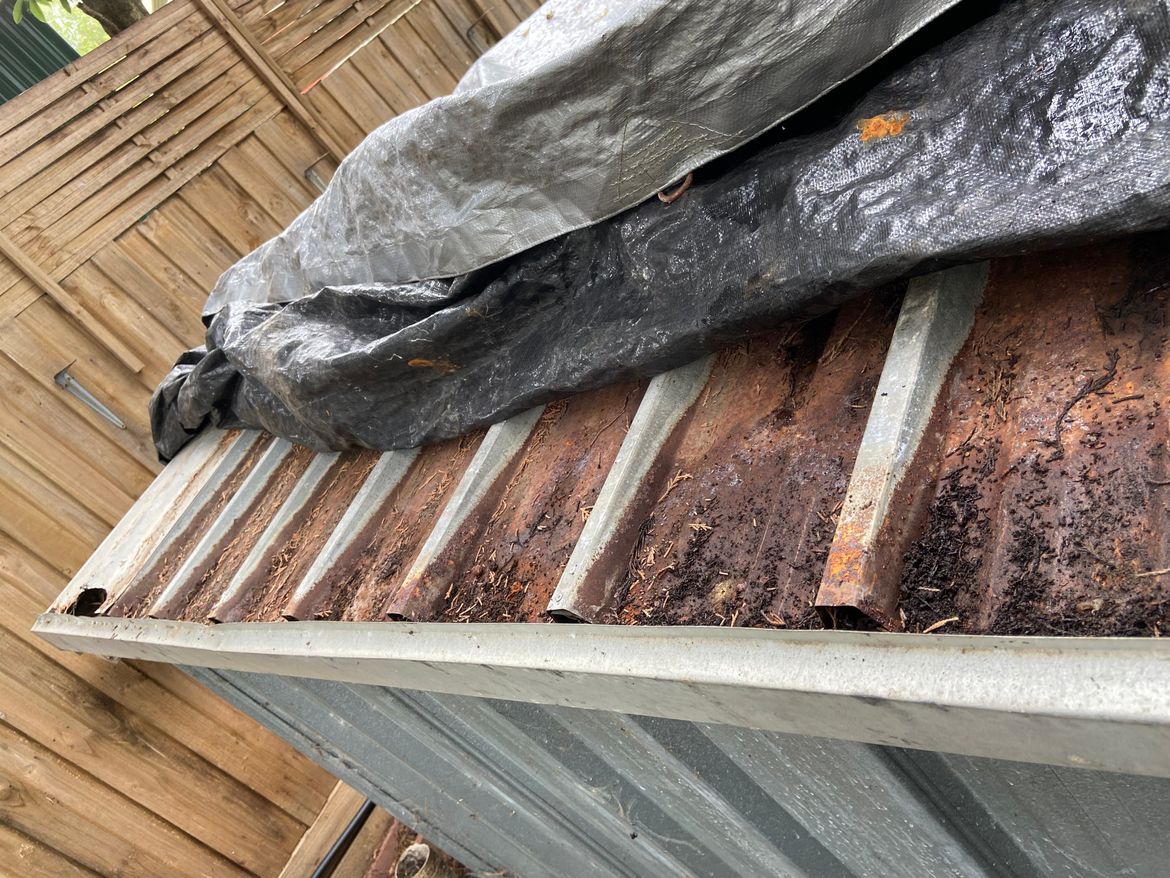

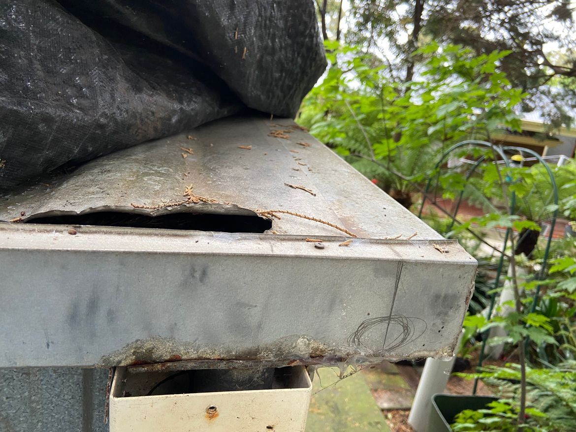

I have a shed that leaks from the gutters, my shed has a box guttering system. I would like to cover the gutter with a new guttering is this possible?

Good morning @Rolfe123
Never fun having rust in your gutters, I have had so many holes I could see the stars in mine 😕 Is there any chance of a further back photo so we can get a better idea of the guttering?
You have removed the utters already or does the gutter go up and around? A photo end on would be handy as well.
Covering guttering is probarly not possible 😕 I have used a plastic product called gutter repair to stop leaks, it does work but is only a short term solution. (To get you out of the immediate issue) It looks like a wide black tape. Deks 140 x 500mm Black Rapid Flash Repair Strip

Hello @Rolfe123
It's great that you've received great advice from @Dave-1 and @Jewelleryrescue. Just to add to the suggestions made, I recommend having a look at Consolidated Alloys 75mm x 3m Weatherproof Byute Flash Flashing Tape, it's ideal for these types of repairs.
If you are referring to installing a gutter within the gutter, I don't recommend doing this as it will lead to both gutters deteriorating in a short amount of time. What will happen is that moisture will get trapped between the gutter layers which will accelerate corrosion. I suggest replacing the gutter that you currently have with a new one rather than sandwiching them together.

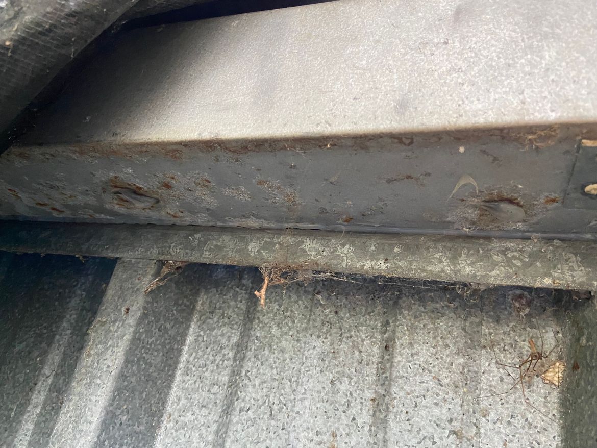

I am in the midst of laying out the flashing but Inam finding difficult to lay due to the ridges, is there any knack of laying the flashing neatly?IMG_1602.jpegIMG_1604.jpeg

Hi @Rolfe123
The aim would be to get that flashing under the  roofing tin laying  more flat,  With out that flashing under the  roofing sheets we are fighting a loosing battle.
So the water  flows off the roof  over the flashing down the gutter.
So that guttering section is being used to hold the roofing sheets into place a close pressue fit.
@Rolfe123   Is is possible to flatten that flashing out and slide the flashin from the inside of the roof also into the guttering section/
You may have to put a timber wedge ,  chisel between roof sheet and the shed  base to lift it 1mm to slide flashing through.
So the aim is the flashing joins the  roof in the same way repairing the hole form with in.
or you can use a small piece of flashing and just externally repair the hole seal with silicon, not the full lenght,  Try get the alumminum in the gutter groove not over it,
Great  work so far  we  willl get there.

Hello @Rolfe123
After having a closer look at your roofing assembly, I propose removing the front covering panel by drilling out the blind rivets holding it in place. This will then allow you full access to the small gutter that is attached to your shed. I've now noticed that a fair bit of repairs was applied to it and as you've said it is still leaking.
Once you have the gutter cover off, I suggest scrubbing the rusted portions of the gutter with a steel brush and patching it up with Consolidated Alloys 75mm x 3m Weatherproof Byute Flash Flashing Tape. I then recommend putting on Selleys 290ml Clear Storm Waterproof Gutter And Roof Sealant where the gutter side and shed wall meet.
Looking at your roofing edge, I recommend brushing the rusted portions as well and applying White Knight 300g Cold Gal Silver Rust Guard Spray Paint. Once you've applied all the repairs, you can then re-attach the front cover to the shed.
In regards to the lead flashing, I propose using a short piece of timber and a mallet to shape it into your roof covering.
