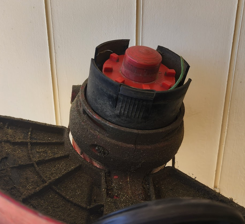

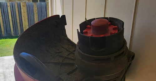

I have the below whipper snipper
Starting to show ware and tare

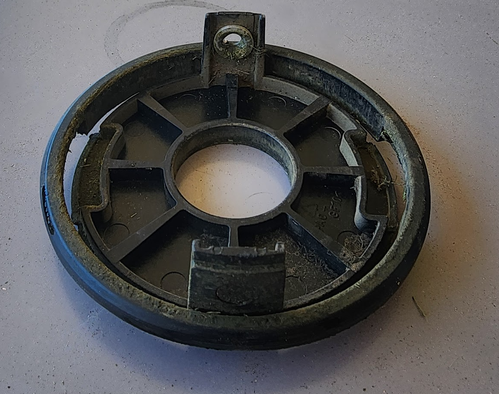

broke release tab as below
Other side tab not broken
have contacted ozito no response Can plastic head parts be replaced at all or can the below universal part be used on otito trimmer

Bunnings used to stock below part cant find anymore does anyone know if i can get a replacement for this part if so where
Thanks

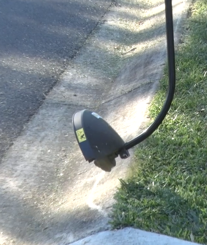

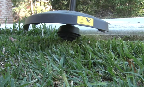

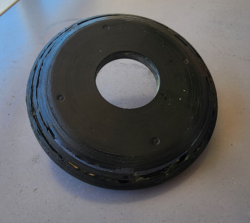

It's common for bump caps to wear like yours due to effectively resting the head of the line trimmer on the ground while in use. Hence why the outer edge of the cap has worn all the way through.
As a tip moving forward to eliminate the excessive wear on the bump cap, here are a couple of tips to try:
And to help make the trimming line last longer, start further away from the cutting path and slowly make your way in before continuing along. You will also cut much faster with a neater cut. This is because it's only the last 10-15mm of the trimming line thats actually doing all the cutting. When you move too close in, especially against rocks and brick edging, the line bends and wears/breaks further up the line.

Welcome to the Bunnings Workshop community @Carlton. It's fabulous to have you join us, and many thanks for your question about line trimmer replacement parts.
The cover for the spool is available to order through your local store's Special Order desk with part #341130001980.

Parts will not appear on our website as they are not in stock in our stores.
You will have to contact the Special Orders team at your local store or our Spare Parts team for assistance ordering the part.
