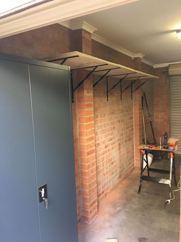

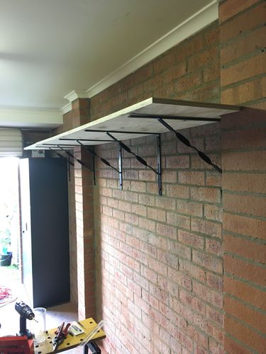

I've just installed shelving in my garage......and I've come across 1 small problem.

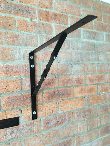

I installed heavy duty shelf brackets with 8mm x 60mm Anka screws.
Each bracket has three screws........and unfortunately 1 screw in 1 bracket stripped out. I am assuming the crumbly / brittle brickwork broke, and the thread didn't take in the brick.
The screw that didn't take is the top one on a bracket.....so therefore the attachment that is taking most of the load I assume.
Anyways.......I need to replace the Anka screw with something, but not sure what.
I used heavy duty brackets, rated to 300kg.
19mm structural ply.
And the 8mm X 60mm Anka screws.
I am not sure of the weight I'll be loading on the shelves, but wanted to make it completely sturdy so it can take a good amount of weight.
Pictures attached here.
Appreciate advice from those that know what I should do to fix.

Hi @gmw72 , those screws are designed i think to only go into a solid substance, so it there is a cavity in the brick when you drill there is nothing to compact when they tighten, you will probably need to replace them with some DynaBolts or Loxin achors
Welcome to the Bunnings Workshop community @gmw72. It's wonderful to have you join us, and many thanks for your question about installing Ankascrews.
I just wanted to confirm that Ankascrews are suitable for hollow bricks; I did need to double-check, though. As @wooshka mentioned, you must be very careful when tightening them, especially in hollow brick. You need to tighten them until the fixture is held firm, but do not over-tighten them. One turn past firm, and you'll start stripping the brick out.
I'd suggest your best option here is to move the bracket over to a new area and re-install it. I wouldn't recommend you install a Dynabolt into the same crumbling hole, as I can't imagine it would grip the crumbling material any better, even though it expands.
If you think you might have stripped out a few of the other bricks, you can back your Ankascrews out and squeeze in some Ramset 300ml Chemset UltraFix Plus before re-inserting your screws. This will glue the screws into the hollow brick and fill any voids. Although this product sounds like a solution to your current predicament, I wouldn't necessarily advise you to use it as a quick fix for a brick with no internal integrity. It's more so for glueing a fixing into a non-compromised brick.

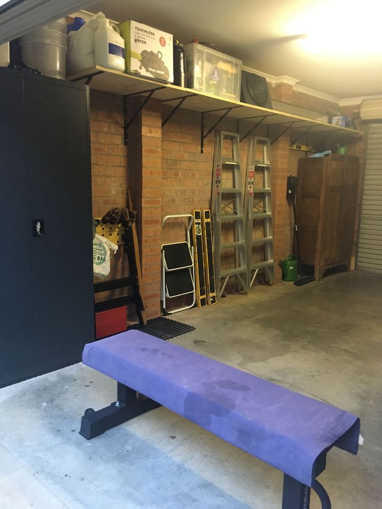

Attached here is a picture of the finished shelf now, and partially loaded with items.
Can you advise whether I am correct in thinking the universal anchor won't likely be strong enough......and if I should go with a chemical solution?
I am really not wanting to re-drill / move the bracket if I don't have to.
Many thanks.
Grant.

Hi Grant @gmw72,
I have concerns about using a Ramset Universal Anchor in a compromised hole. I'd be more comfortable with you glueing the Ankascrew in place. However, there is no better solution than moving the bracket slightly to the left or right to fresh material. If you couldn't possibly move the bracket, then I think it would be worth entertaining the idea of changing/glueing fixings or packing out the hole. That doesn't seem to be the case here, so I'd recommend shifting the bracket over 5cm. You'll then have a shelf that you can load up to full capacity without ever having to wonder whether your fix worked.
As someone that suffers from lifelong injuries because of a shelf failing due to incorrectly installed fixings, I'd hate to see you or your loved ones injured when a permanent fix involves just a slight relocation of a bracket.
