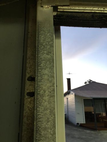

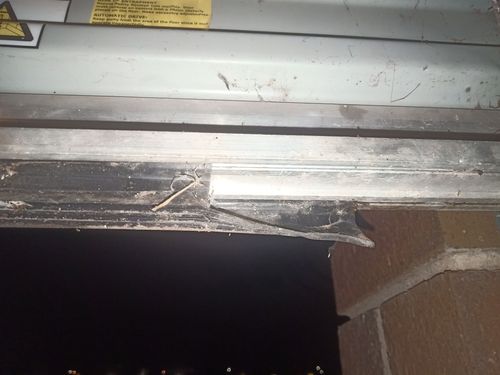

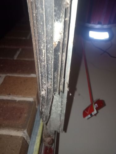

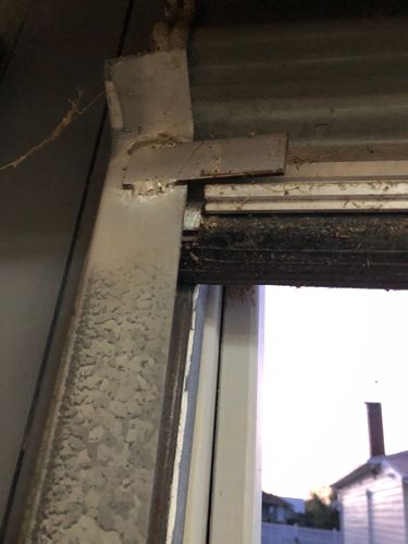

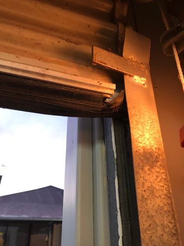

hi team iam looking to replace double garage rolling door bottom seal but when checked couldn't match existing with it B&D or moroday bottom seal with item number 4000019 so can you help me based on image which one I should buy as some asking to remove the seal and show the clear edge but I couldn't remove it and it has T ends so couldn't understand how people using U shaped bottom seals

It appears you might need the old style B&D seal, which has a T-section on either side as per the image I've supplied below. Our Premier Blue 5.2m Garage Door Weather Seal also has those same T-sections on either side so it could fit. Raven also has the RP143 Replacement Roller-Door Seal for B&D doors made before 1997, which we can place a special order for.

We purchased the house recently but it was indicated that it was built In 2017 so iam surprised how could they use old B&D 1997 model.however ,how would I remove the weather seal,and do I need to buy any glue to stick it ,based on image of premier blue the adaptor rail seems to hold U shaped seal? So do I need to remove Adaptor rail also and purchase new one, can I have floor seal C link and it will be durable to have floor seal also? And the review of b&D sent by you indicated it doesn't have T edges?

The Premier Blue 5.2m Garage Door Weather Seal that @MitchellMc mentioned is compatible with your garage door. One of the rail guides must be removed so that you can slide the old sealer out and slide the new one in. The "U" shape is achieved by sliding both sides of the sealer at the same time. You will see this when you pull out the old seal. No glue or sealer is necessary to attach the weather seal.
Please make sure that the power is turned off to your garage door to avoid any accidents. If you feel that this is outside your current skill set, I suggest engaging the services of a professional to fix your weather seal. Using the Premier Blue Weather Seal will provide you with a positive floor seal and it should not be necessary to install a floor seal.

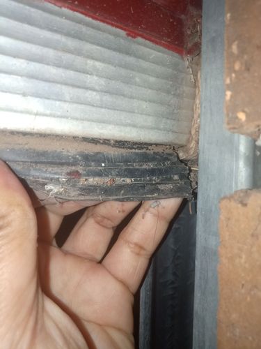

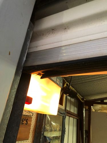

I replaced my weather seal a couple of years ago, mine was an Airport Door brand, I had to go to the supplier to get the one that fitted, it was very easy to install, first I had to remove one of the sliding tracks for the door, then to remove the seal it was held in place with self tapping screws, I just removed them, which allowed me to removed the old seal and install the new seal, just make sure you clean the aluminum bottom track before installing the new seal. see images below.

I replaced the seal on my own, it took me about 1 -2 hrs to replace, I am not sure on how much I paid for the seal. You look in your local area for a roller door repair person, they would be able to supply and fit for you.
@JoeAzza thanks I will search for local guys and only at T end there is gap and I cannot find any possible screw to remove ,I will ask supplier if they can deliver the weather seal to my home .
