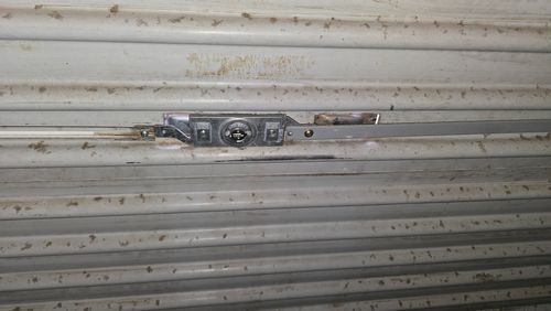

Old garage door lock cannot be removed.  Any ideas how to replace it?  Any spare parts of door lock in Bunning? Model no please? Thanks
Ideal case is to change the lock with whitco lock. Is it possible

Unfortunately, I am not aware of any parts that could be used to repair the existing garage door lock.

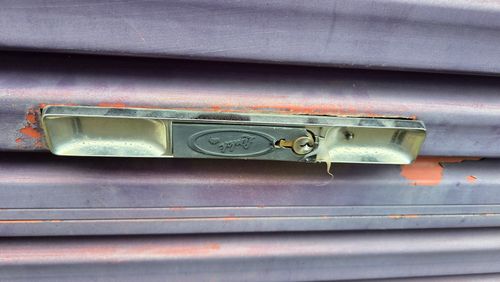

Perhaps replacing it with this Liftaway LA132 Universal Garage Door Lock would be the best way to go.
I note that there is a fairly wide cutout in the garage door that may need to be mended in order to install this garage door lock. If necessary, you could attach a piece of aluminium flat bar over the cutout, then make adjustments to it as necessary in order to mount this new lock.
Let me know what you think.
