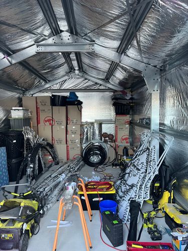

I have recently built a Colorbond shed and looking for some advice on sealing the shed to make it weatherproof etc.
When I built the shed I installed sarking on the walls and anticon blanket on the roof.
I will be installing insulation in the walls and then sheeting the inside with Gyprock, both walls and ceiling, and plan on also sealing the concrete to manage any moisture coming up through the concrete (although I believe the concreter may have put builders plastic underneath).
I also have an electrician coming to rough in the electrical before I put the internal panels up, this includes putting in a fan.
I also plan on putting in a whirlybird and vent which will go through the internal lining to help with circulation.

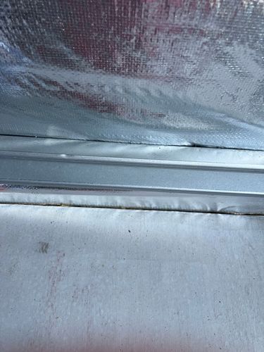

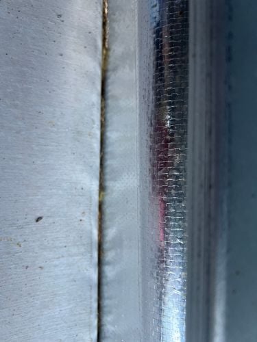

My question is even though I have installed sarking whether I should still be sealing around the bottom edges of the shed to prevent moisture and dust coming up through the gap? The walls and sarking extend roughly 40mm down the slab. Is it ok to put something like an expanding foam or silicone between the slab and sarking? Or should I be leaving the gap to allow for circulation in the walls? I have looked at a number of the previous posts on lining and insulation sheds but haven’t seen a specific answer around sealing between the sarking and slab?

The sarking should be left unsealed because all Colorbond garages and sheds need to breathe.
At the top where the roofing sits on the side and at the bottom between the side and the concrete drip edge.

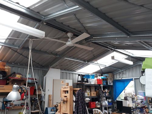

I have not attempted to insulate my workshop, a standard Colorbond garage with roller door offset to the right allowing for storage and benchtop machines along the left, two skylights and two windows at the back - side entry on the right.
On a hot day I open everything up and turn on the big floor standing fan (the ceiling fan makes things worse) and if it it's still too hot I down tools and go inside.
