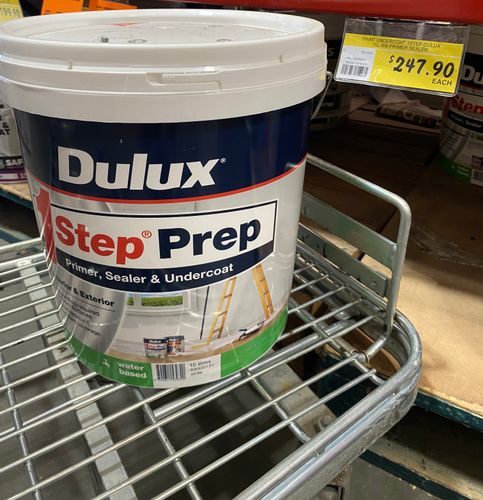

Good morning @Dave-1 Thank you 😊 I purchased the undercoat ready to go. I was going to start painting at 4am this morning as I did with the Damp Stop yesterday morning BUT held back because Perth is forecasted with 40 degrees today and I was advised that it would be too hot to paint, so I don’t want to stuff it up. Just need to be patient and wait for the heatwave to pass.

Yeah I know that type of recomendation lol (I had it for my concrete paint for my patio and even tho I started latter in the morning I was getting way to close to that 35degs that was recomended for the paint
) I have seen the recomendations for years and had never paid any real notice until you spend the $$$ and then it becomes imporatnt ![]()
As you said, patience is the key.
Great thread to follow, good choice @mich1972 to avoid the high temp. I painted concrete while living in Broome, temp went up as the morning progressed, outcome was the paint flaked and I created myself a long and complicated reno job afterwards!! Lesson learnt to take note of the instructions on the tin and plan ahead 👍🏻
@mikepilling2 Thank you 😊 it’s 10.30am and already 34 degrees so I’m glad I didn’t do it. I’m learning heaps from everyone in the Workshop, which gives me confidence to try and do it myself. I was going to epoxy the concrete slab but won’t now, so I’d like to paint it instead with a concrete paint. Just waiting for the heatwave to pass, hopefully start painting the walls soon !! 🙂
