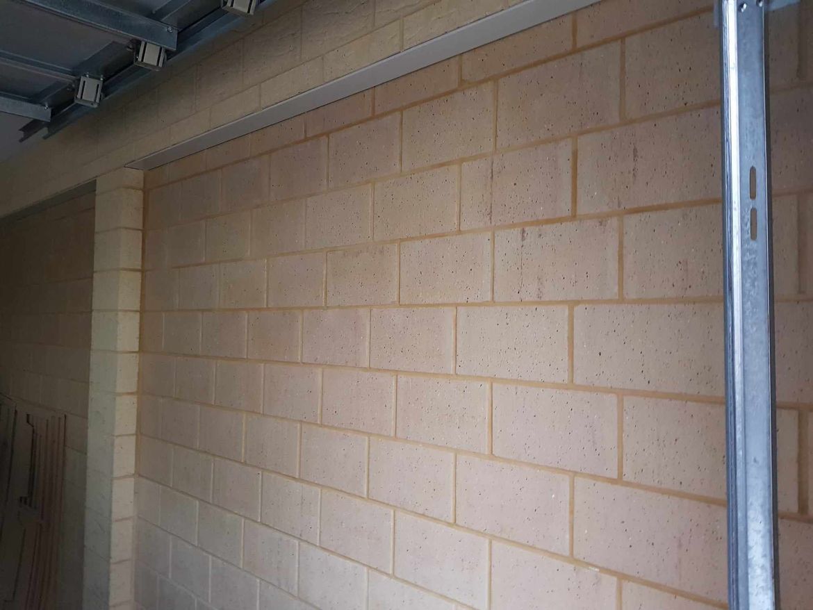

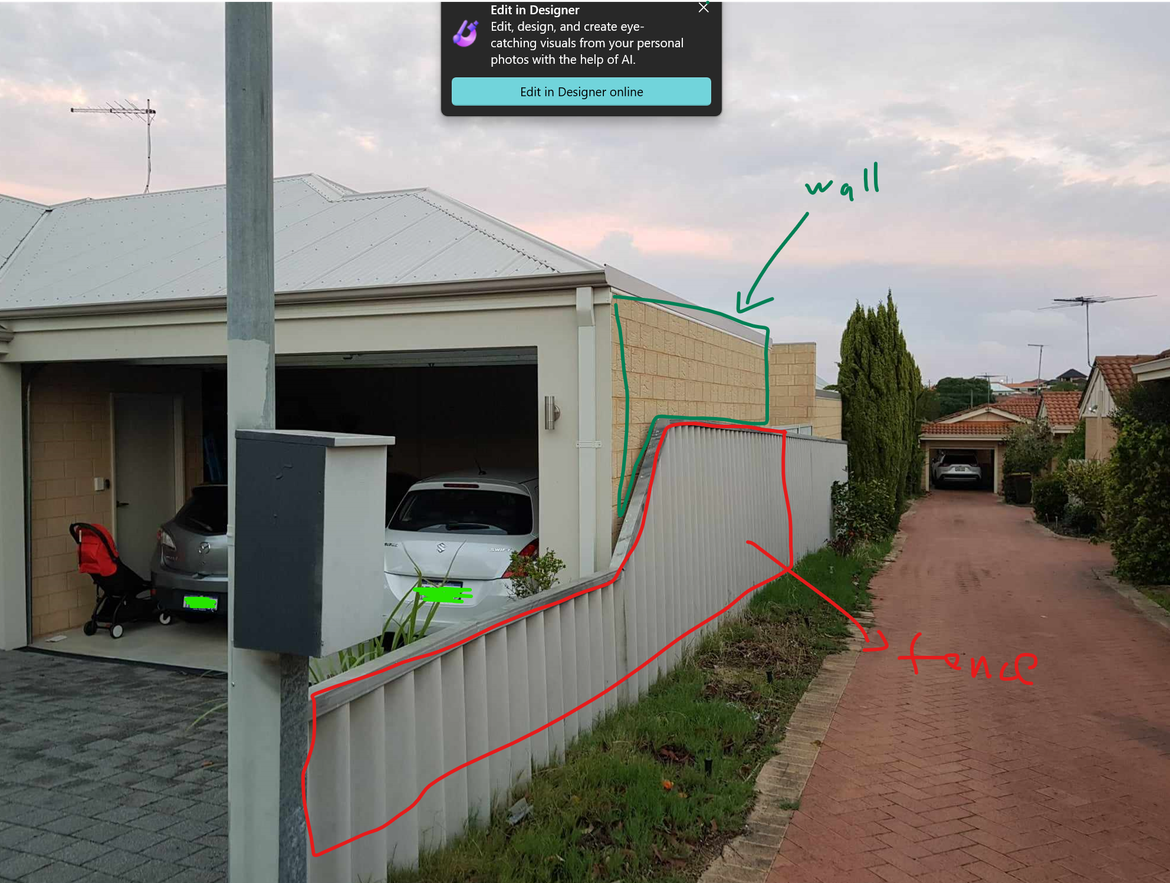

hi, i've found out that water is seeping through my garage wall and I think some maintenance work is required to be done so that it does not cause a big problem down the road.
there are 2 big questions I need help of.

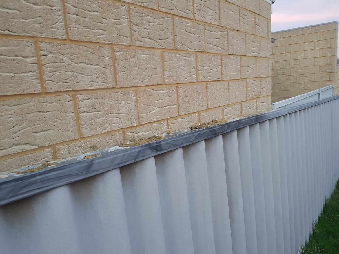

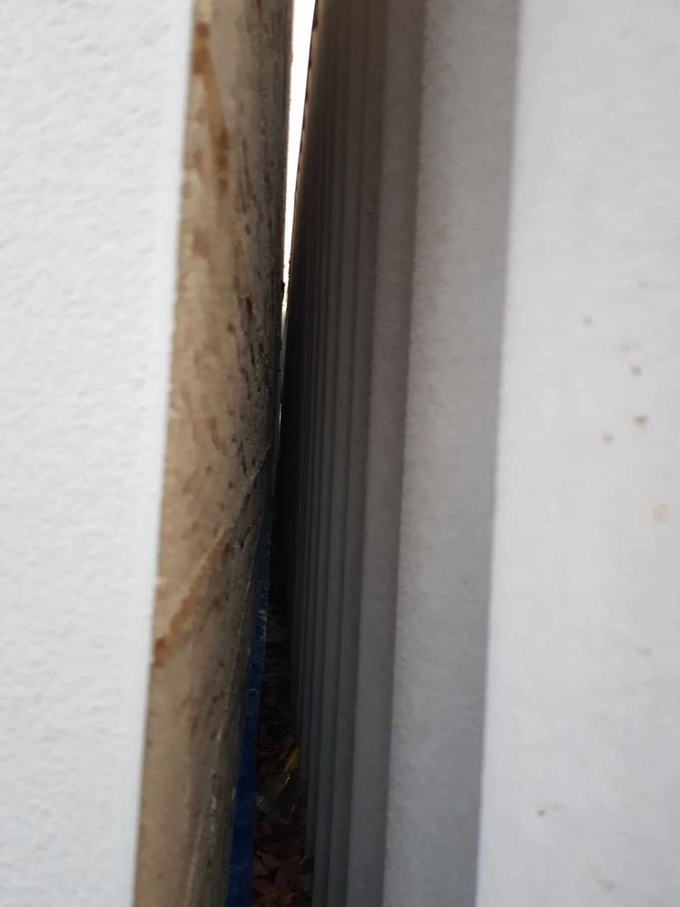

1) Could anyone provide some details on how this dividing fence is installed? Is this hard to be removed for access purposes?
2) what kind of maintenance work is recommended for my garage wall once access is allowed. My mind is hard-plaster the wall to patch gap opening and put on water-repellent paint over it?
I am looking forward to any suggestions.

The fence could be removed, but it will require a decent amount of work. Given that your home appears to be newish, I suspect the fence is fibre cement. If this is an old fence that has been left in place, there is a possibility that it is asbestos, as that was a commonly used profile. If the fence was built after 1990, then it wouldn't be asbestos.

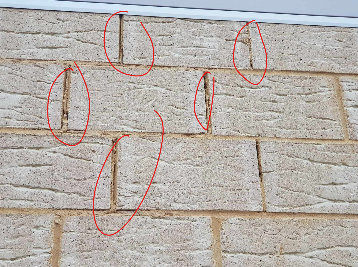

The areas you've circled in the image appear not to have had mortar applied correctly rather than a deterioration issue. They can be filled with mortar that's been coloured with an oxide or mortar gap filler.
You could paint the wall, but first, I'd have a professional check to see whether there is a drainage issue on the roof that's allowing water to penetrate the top of the wall. There might be a leak allowing water to enter rather than water penetration from the face of the wall.
