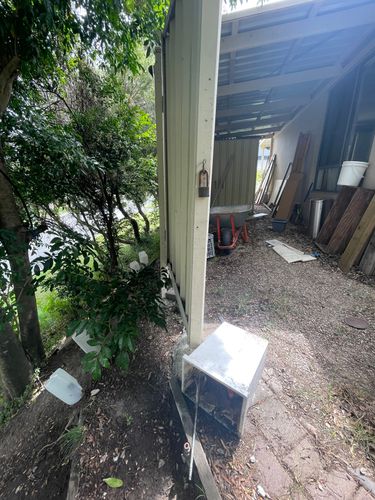

Hi guys again

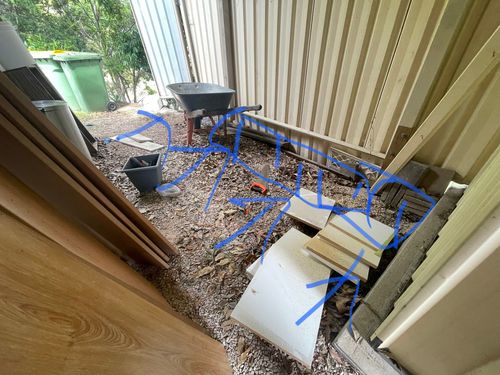

Out of my many other projects, this one is very dear to me.

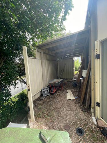

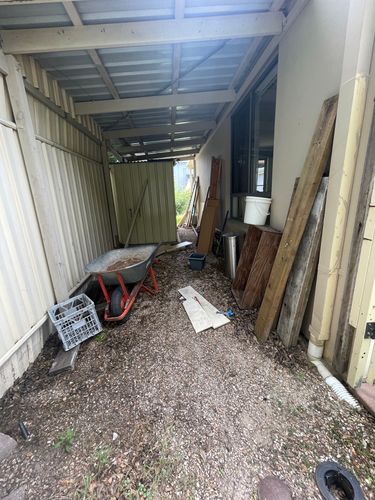

there is a plenty of undercoverspace outside the shed attached to the house. I have been using this area to store something that is not being useful in the time being.
I would like to turn this area into gym space and build gym area( fitting solar lighting and sound I can do that later).

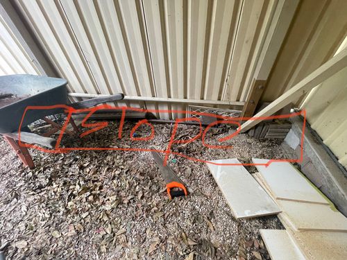

however this area is not completely flat and there is a slope starting from the edge of the house to the colorbond fence ( indicated on the arrows and shaded blue and red areas).
 Please suggest me how to flatten the area to some extent and what can I put on the floor to put gym equipment?
I was planning to put those rubbery matts what they use in the Gyms.
I highly appreciate your time and expertise on every question from me.
Regards
Sugarman

@MitchellMc Thank you for your reply.
While spreading the aggregate and compacting it, how do you think we can manage a flat surface while there is a slope towards the bottom of the colorbond fence.? Do you think we have to plaster the surface, but this will be more time consuming and expensive but reliable at the same time.
I have another option to take the excess from the highest part of the slope ( scrapping the elevated part of the land) and bring to the same level.
There is already pebbles I believe I can put aggregate on top of the existing pebbles.
I hope I explained to make you clear what I wanted to say.
Thanks.
Re: Turning Shed into Gym Space
You might like to install some sleepers along the bottom of the Colorbond fence @Sugar. They'll need to be securely anchored in the ground with posts. This will provide a rigid structure that the aggregate can be built up against to correct and level the surface.
It will likely be best to do as you suggested and adjust the slope as much as possible from high to low before adding the aggregate; if you can use the existing material, all the better. There are no issues putting the new aggregate over the existing pebbles.
@MitchellMc I will keep update on this to you. I like that idea of the sleeper which I was thinking also. I just  need to find out how to do the POSTS. This will make the structure rigid.
You would install the posts by digging a hole, inserting the post and then filling the hole up with concrete, @Sugar. A slightly easier option than the posts is to use sleeper stakes. You hammer these into the ground and attach them to the sleepers. They are not as rigid as using posts, though.
