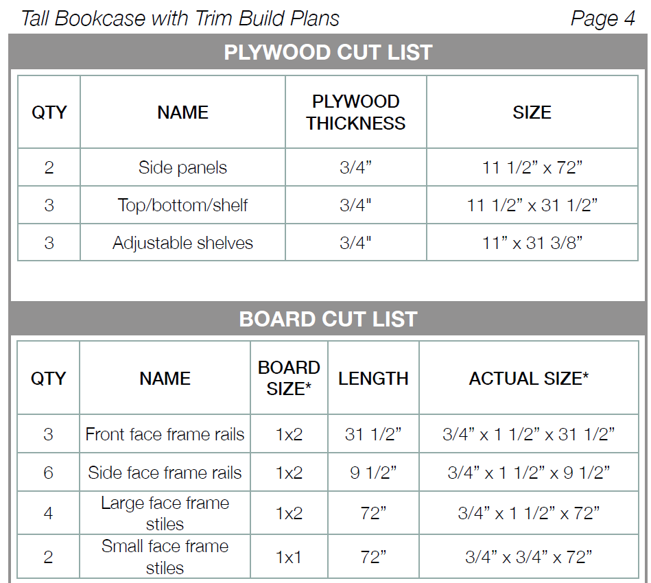

Hi
I am a beginner in woodworking and wanted to start building from a smaller DIY project. I have a plan for a bookshelf which I will be using as a shoe rack. In the plan the timber sizes are as follows:
1x2 8'
1x1 8'
Now, I understand the 8' = 2.4m but how about the 1x2 and 1x1?
Also, which type of timber to be used in the project as the shoe rack will be stored in the garage.
Thank you in advance.
