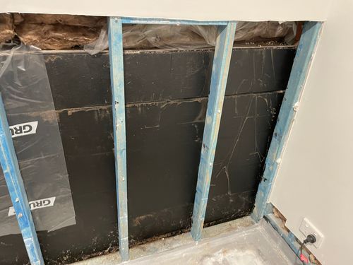

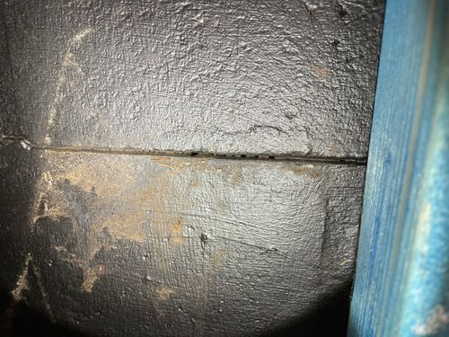

I’ve got a late 1960s high set house, so the slab doesn’t have positive side waterproofing (pretty sure the original owners sorted the slab themselves).

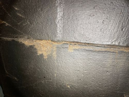

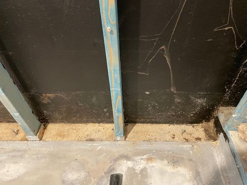

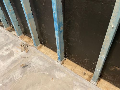

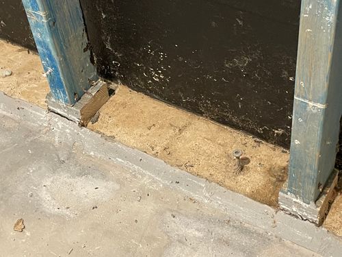

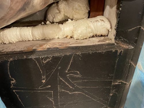

The lower level isn’t legal height, but I’ve built another spare bedroom downstairs. Timber framed, gyprock sheeting, insulation. When the base plates for the stud walls were put in I didn’t put waterproofing down, so there is water coming up through the slab. The side walls have bitumen paint on them that seems to have worked. I initially did the same for the flooring, but with the rains back in early 2022, that was pushed up and had to be removed mechanically. Since then I put down Davco K11 - an alkali reactive cementitious waterproofing product. After Alfred came through recently, there was minor flooding coming through where the studs were drilled into the slab and under the studs. I know I’ll have to remove the baseplates of the studs and replace them.
I’m after advice on waterproofing products to use, whether or not the baseplates can be steel studs or I should go with timber again with adequate damp proof treatment between the timber and slab, or just any general advice. Waterproofing products would need to be negative side.
