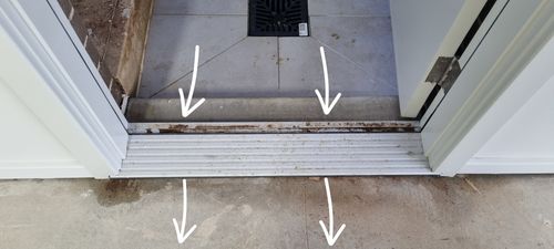

The bottom aluminum frame of our exterior garage door is not sealed and causes water to come in to the garage.
Any suggestions on sealing this frame to make it waterproof?

Thanks Jacobz for the suggestion. Could you suggest a door bottom seal that is suitable for this door?
The water seems to come in below the aluminum frame on testing.

Do you happen to know why this does has been installed to open outwards instead of in? Is there something obstructing it inside? Typically, exterior doors open inwards, and I'm just wondering if this might have something to do with the water entering.
There is a sill on the inside of the door. Do you think the water is coming in under the door and then up over the sill? Or, as @JacobZ mentioned, could it be moving under the sill?
Adding the Moroday MDS2B Self-Adhesive Black Econo Door-Seal on the outside could prevent water from travelling under the door and inside.

Thanks @MitchellMc for the response. As this is a double garage, the door opening inwards could block one of the 2 cars if parked inside.
Thanks also for the suggestion on the door seal.
I did try to pour water under the sill to check and it went through the other end.

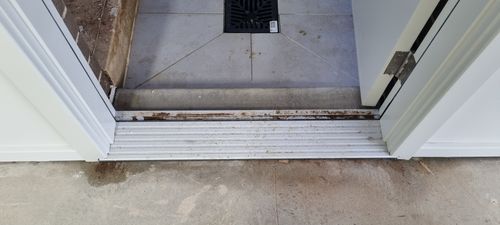

Hi @badmojo,
I would suggest you apply a bead of Sika 11FC of a suitable colour to match, between the bottom of the sill and the concrete on the outside of the door. Clean the area thoroughly, allow it to dry and then apply the bead following the instructions in in How to apply silicone sealant and How To Silicone a Gap.
Make sure to keep a bucket of water and sponge nearby for any cleanup as it is easy while the sealant is still wet but can prove quite difficult after it has set.
Let me know if you need any further advice.

Hi Bunnings Workshop Team,
I did my best with the sealant.
Re: How to waterproof door frame?
That's looking great, @badmojo. Well done.
