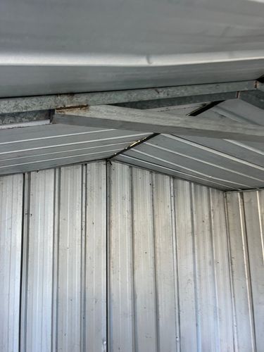

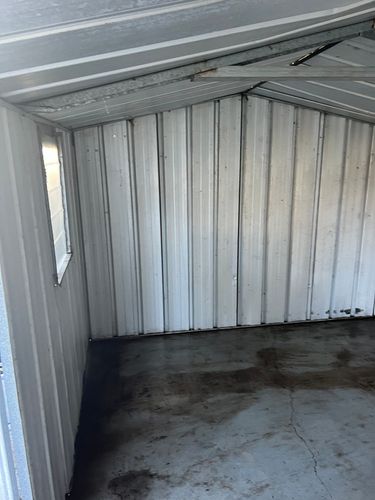

Hi there my shed has been leaking in water and the contents in there have gotten a mould on there. What can I do?

Is that light we can see between the two roof panels?

I think @Jason has spotted the first thing to approach. That roof spine has lost its cap by the look of it. You can see light through the length of the spine.
Something along the lines of this Fielders 390mm x 2.4m Zinc Roll Top Ridge Id prefer flatter but couldnt see any in Bunnings, colourbond does have them so maybe the special orders desk would be able to help you out.
Water also looks like its coming in from the bottom edges, I would suggest to mount the things you want to store on shelving or cut down pallets.

2. The light you can see through the top sections of the roof that others have noted is very normal in both shed and even more substantial metal roof designs. So, unless rain is obviously entering here, then this isn't the source of your issues.
3. The likely source is from the ground where thew bottom of the shed walls meet the concrete slab. With the concrete dry, run a thick bead of this Sika product internally along the bottom of the shed walls and more thickly over any fastening points.  Then the next time is heavily rains check to see where there are spots missed and mark them. When dry add additional sealant and so on. This is how I have successfully sealed my own and many other sheds.
4. Lastly as I mentioned garden shed are not designed to be water/weatherproof. If you are storing moisture sensitive items in there, then you may need to consider additional storage requirements like sealed tubs etc.
