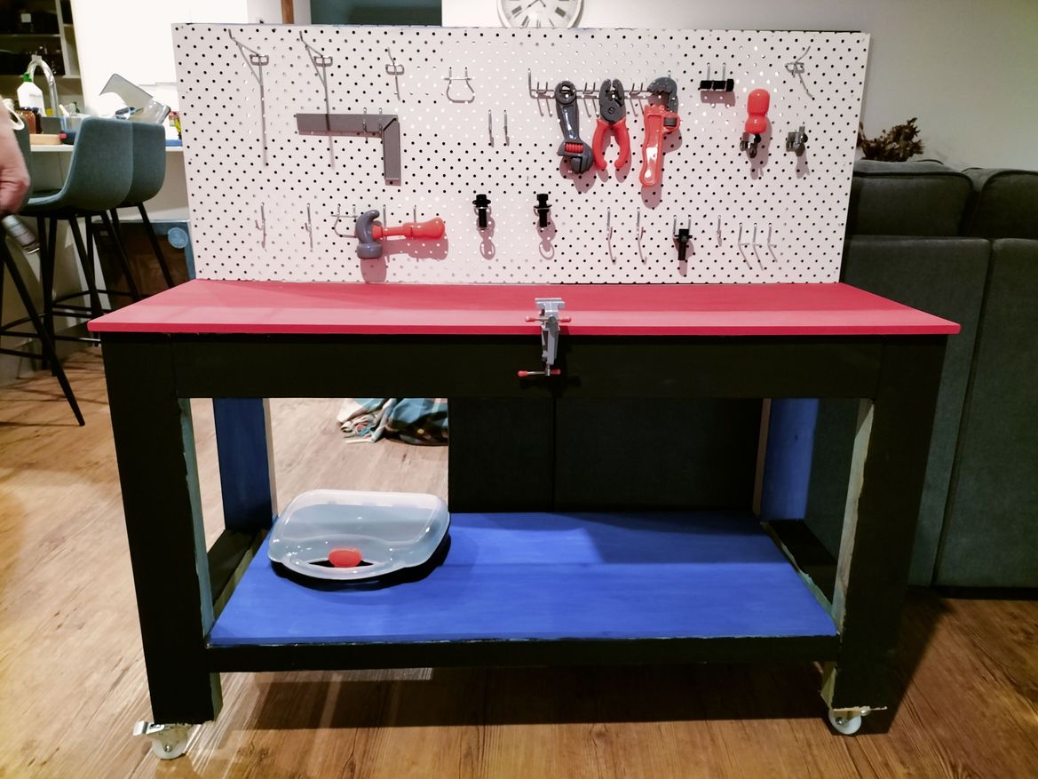

I wanted to build a work bench for my grandson who is 2. I found a plan online to use for an idea of what I wanted. I used the plan as a base but the complete design is all me.
I wanted it to be portable so it could be moved outside or put away.
Materials
PINE STRUCTURAL MGP10 BLUE H2
90X45MM 2.4M
70X35MM 2.4M
SCREWS T/PINE TC ZENITH,10X65 SQ PBX50
MDF STANDARD PANEL 1200X450X12MM
SCREW CHIPBOARD ZENITH
8GX30 PHL CSK GP PK35 EDA6430
CASTOR BRAKE MOVE IT 50MM
CASTOR SWIVEL MOVE IT 50MM
Poster Paint tubes - red, blue, black
Tools
Ozito Impact driver - https://www.bunnings.com.au/ozito-pxc-18v-impact-driver-skin-only_p6290472
Ozito Circular saw - https://www.bunnings.com.au/ozito-pxc-18v-165mm-circular-saw-skin-only_p0033141
Ozito drill press - https://www.bunnings.com.au/ozito-450w-corded-drill-press_p0412276
Electric plane
Electric belt sander
Ozito Nailer - https://www.bunnings.com.au/ozito-pxc-18v-cordless-2-in-1-cordless-nail-and-staple-gun-pxngs-018-ski...
