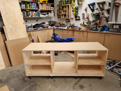

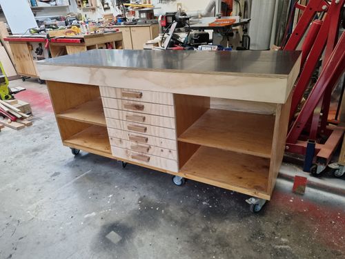

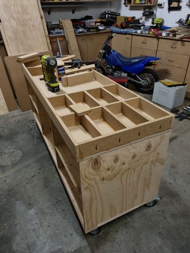

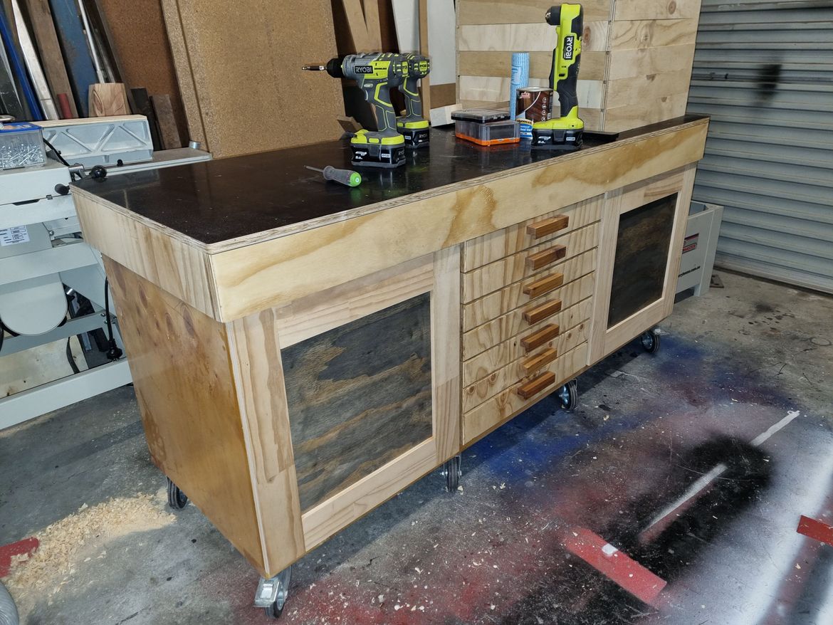

Thought I would put this up. Here is a mobile workbench I built for the garage. It's 1840mm long X 660mm wide and 860mm high. It's made all out of 18mm ply, with 17mm formply as the top, for glue ups and easy to clean. It has a mdf torsion top to keep it flat and level. The draws a shallow for sitting my regular used tools. I will put my photos up when I can

Yours looks nice and sturdy, with plenty of storage, wheels for manoeuvrability and a slick top for glue ups and ease of moving materials.

Looks terrific @Razzer
Love the functionality of the design with its storage elements and the finish quality looks top notch. Well done 👍

I ha dto look up what a "mdf torsion top to keep it flat and level" was, as soon as I saw it I remembered. So the question becomes, what are you making that requires such a level top? Or is it something that you find is just easier to work with?

It makes it alot easier to build stuff with a level surface. Plus I also do some welding on the top aswell. A torsion top is so easy to make and makes it easier as an out feed table. I've even done my mobile table saw/router bench the same aswell. Some pics of that build will come once its completed.
