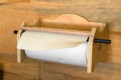

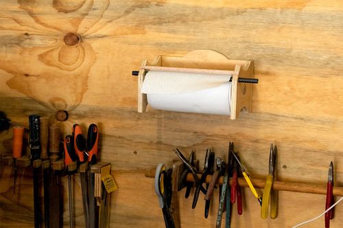

Having an assembly table is all well and good but when I gather the equipment I need to put something together, I often forget to grab a few sheets of paper towel for wiping up glue spillage or squeeze-out.
By the time I remember, I usually have glue on one hand or the other and having the roll of paper towel just laying on a shelf or bench doesn't make for simple one-handed operation.
So I built this doohickey and screwed it to my tool wall. It'll have to come off for an oiling next time I mix some up.
Towel roll holder close up.Towel roll holder close up.Towel roll holder showing location on the tool wall.Towel roll holder showing location on the tool wall.
Note the use of a paper feed roller from an old scanner/printer that I salvaged.

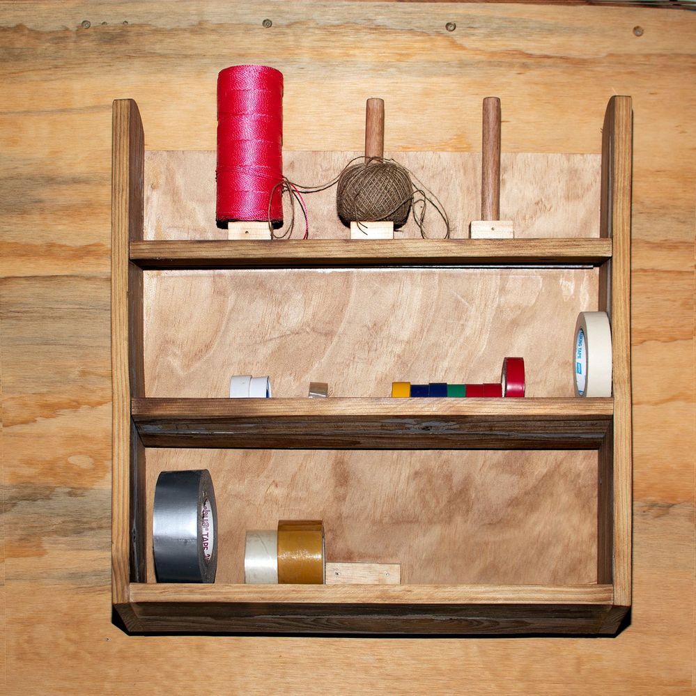

Next up is a way to deal with rolls of tape and balls of string.
This has been way over designed, but I imagine that it won't take long to fill up with different sorts and sizes of tape.
The two tape shelves are angled and are lower at the rear than at the front. This keeps the rolls on the shelf without having to have a lip at the front edge.
I could probably have done without the extra blocks for the string spindles. The dowels go completely through them and halfway into the top shelf. The idea was that the balls of string would sit down over the blocks and they wouldn't be seen. That obviously isn't the case.
Somehow I didn't take a wider shot, but this rack is directly above the plier rack which meant that the paper towel holder had to be taken back down for a while.  I'm considering mounting it under the lip of the assembly table instead. At least the paper towel rack finally got its long-awaited finish of boiled linseed oil cut with mineral turps at the same time as the new rack.
Rather than screw this to the tool wall through the thin 3mm plywood of its back, this rack is mouned via a French cleat.
The tape and string rack. Oiled up and hanging by a French cleat.The tape and string rack. Oiled up and hanging by a French cleat.

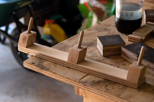

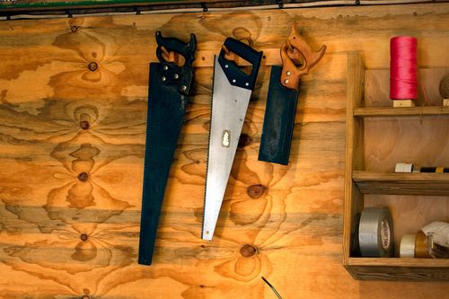

This one is for three handsaws, or possibly hawks. No, I'm sure they're handsaws. I know the difference.
I wanted some dowel pegs to come out of blocks of wood at an upward angle, but cutting angled holes in wood is a little bit tricky.
I know that with a nice drill stand with adjustable table, a good machinist's vise and a sharp hole saw or preferably a Forstner bit there would be no problems. But sadly I don't have a drill stand, adjustable table or a good vise. And the Forstner bit set I got from Bunnings, well, I won't say they wouldn't cut butter. They would, but you'd have to take it out of the fridge for an hour or so first.
Anyway, enough whining about poor tool purchases. The approach I took was to drill a hole squarely down the middle of a length of wood and then cut off angled blocks.
Sawblade set to random angle that looked good.Sawblade set to random angle that looked good.
After that it was just a matter of sanding everything, gluing the blocks onto a strip of scrap plywood and glueing in the dowels. Let the glue dry, coat of BLO cut with turps and screw it to the tool wall.
Assembled and fixed.Assembled and fixed.
Screwed into position.Screwed into position.
Close up of hanging saw.Close up of hanging saw.
Bob's your uncle. Have a good long weekend, get plenty of shed time!
