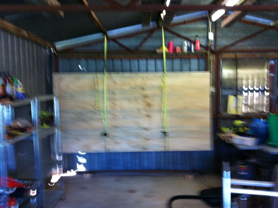

It starts with getting some plywood fixed to the timber cross-pieces on one half of the back wall of my shed. This is 19mm plywood, what the Cousins would call 3/4".  I seem to recall, when I was learning this stuff from my late dad, that we would size it simply by the number of layers or laminations. Thus we had (iirc) 9-ply, 5-ply and 3-ply. If 3-ply was 1/4" it makes sense that 9-ply was 3/4". I suppose 1/2" got short-changed to keep an odd number of laminations and so keep the grain on the outer faces in the same direction.
Anyhoo! One thing that has changed is that a full sheet of 9-ply/3/4"/19mm plywood is approximately 37 times as heavy and awkward to handle as it was in the days of my youth. And 137 times as expensive!
I have a few webbing ratchet tie-downs so I rigged two of them and, singing a sea shanty to myself, heaved away and/or hauled away.
Thus we get to the first photograph.
This has become far too long so I shall follow it up in the next few days with progress reports of different tool mounts.

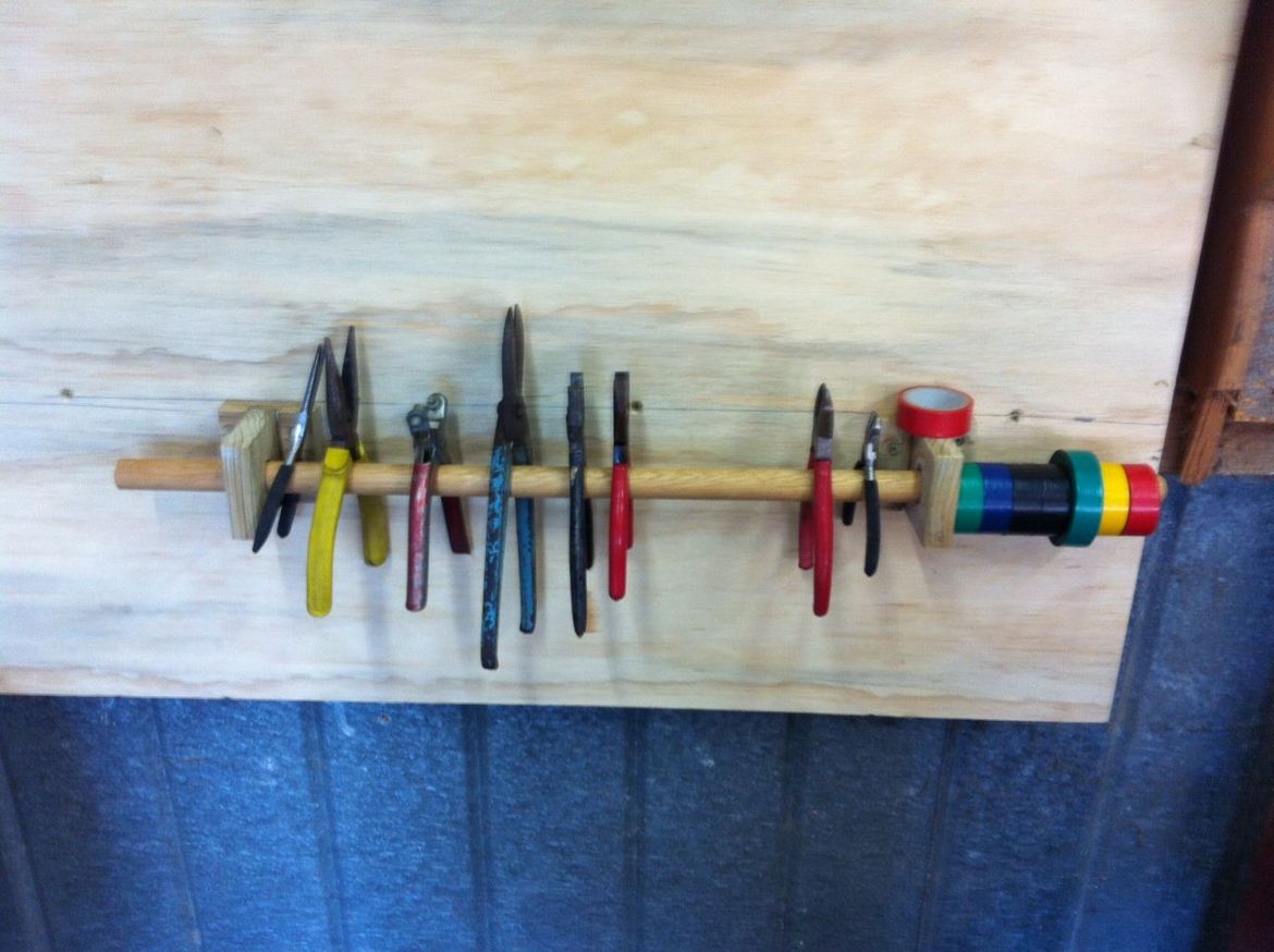

Alrighty then. Seconds out, round two.
Behold the glory that is the plier, side-cutter, and related tools rack. And temporary tape holder.
This isn't a great solution for tapes because of the lack of access and will be re-visited soon.
Those are genuine hand sawn and chiseled through-dado joints, but they're 'loose as a goose' not 'snug as a bug' because I'm many years out of practice.

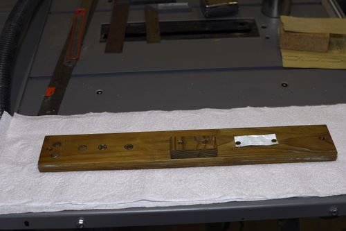

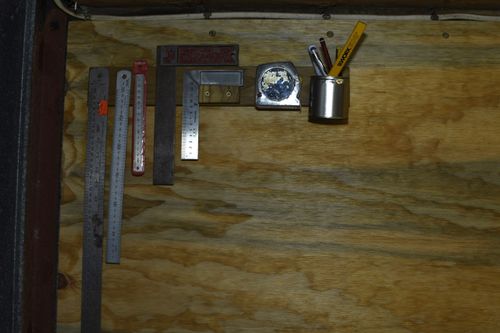

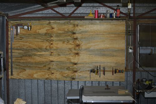

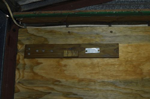

I had put together a mount for measuring and laying out tools last night and left it so the superglued magnets could set properly.
This morning I gave it a quick coat of 50/50 boiled linseed oil and turps. The entire tool wall and the plier rack had also got that treatment earlier.
Anyhoo, here's some photos, taken with a decent camera this time. I might try Workshop's option of smaller photos. Please let me know what you think.
Oiled up like a gladiator. Do you like movies about gladiators, Joey?Oiled up like a gladiator. Do you like movies about gladiators, Joey?In place except for the pencil tin.In place except for the pencil tin.Loaded up. Earlier tests showed 2 magnets were fine for the 1m steel rule. That may not be the case.Loaded up. Earlier tests showed 2 magnets were fine for the 1m steel rule. That may not be the case.The big view.The big view.
