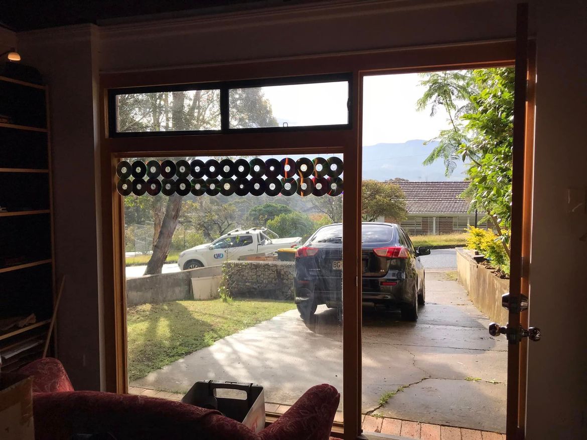

I wanted to have silvered side of the discs front facing and also interior facing so I doubled the disks front to back. I was concerned about the weight of so many discs so I used for cuphooks to support two lots of timber strips. That way I could also dismantle it half at a time if needed.
I only used paperclips to stitch the discs together and also to hang them from the detachable rail.

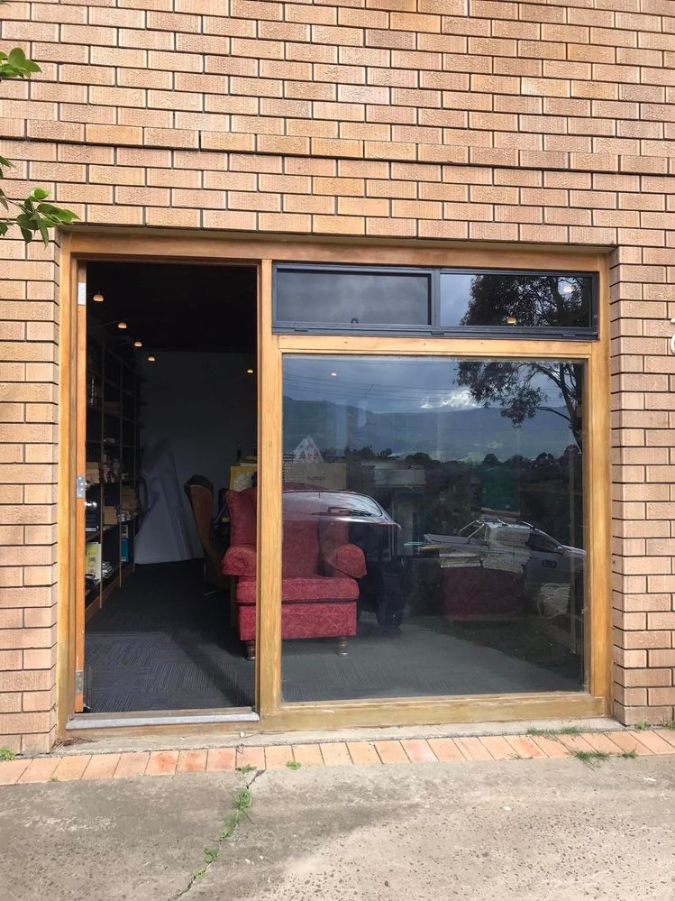

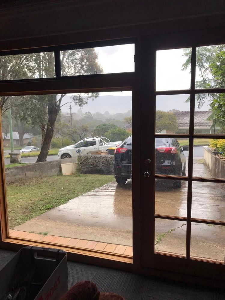

While I was fitting out the room I had a sheet of white paper against the window. It really cooled the room and protected the insides from the sun. But didnt look the greatest.
I really like the view so dont want something that just stays static.
I unfolded a 50mm paper clip so its a big oval shape.
I doubled the discs, that way I could have the silver facing out as well as facing in. I didnt have enough of the same colour to have only one side showing.

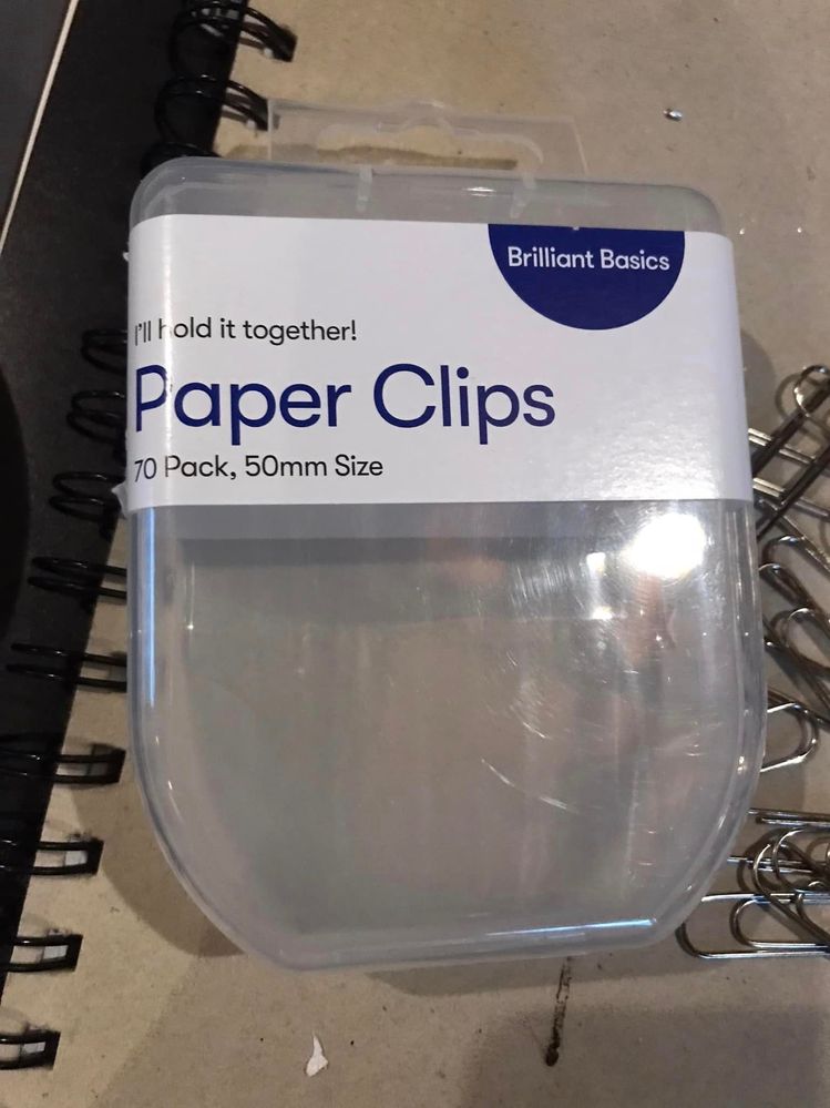

These are the paper clips I bought, went through 3-4 packets worth (Around $20.00)

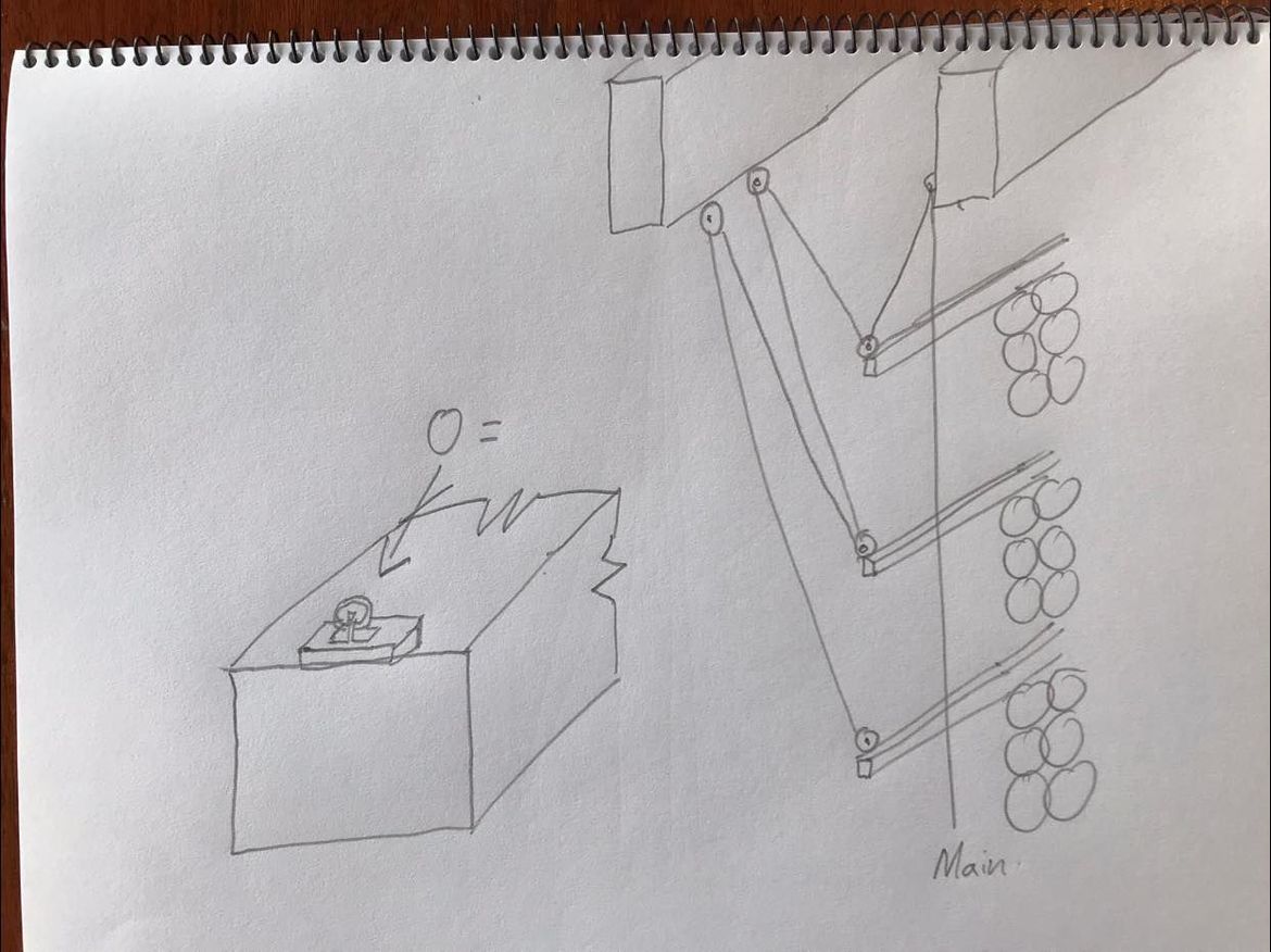

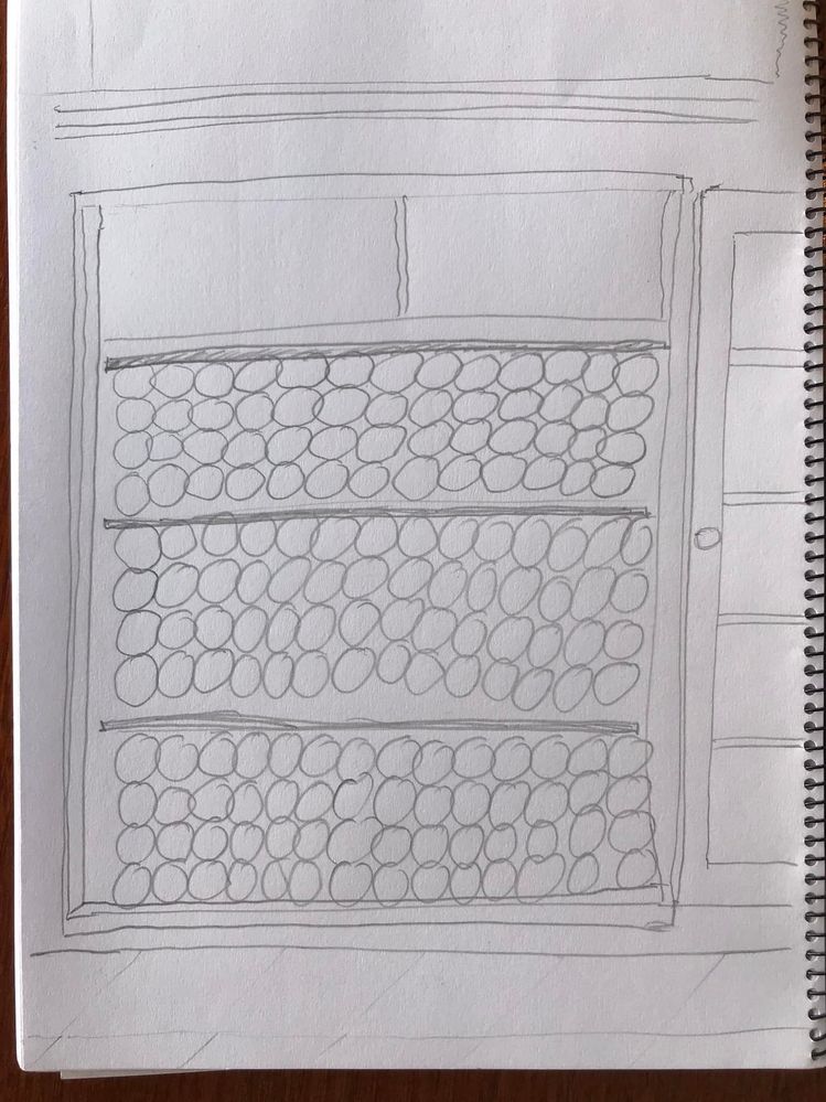

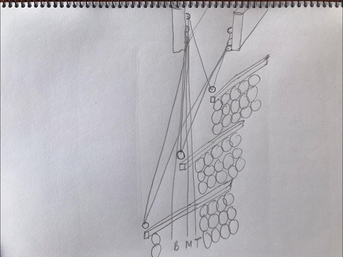

I stitched horizontally every 3rd row to stop the wave from happening with a breeze or door opening. The drawings are showing a possible future way of being able to raise the blind tho it may be over complicated. It would really look the part with the style of the room tho.
Looking inside out and how it would look with a three segment array. I decided this was way to complicated and put it on the backburner to see if I liked the discs in the first place.
The discs were going to be split into 3 segments and would look solid until raised by pullies. The top of the picture would be attached to the overhead beams.
Showing how I was going to fasten eyelets to the ends of the timber strips.

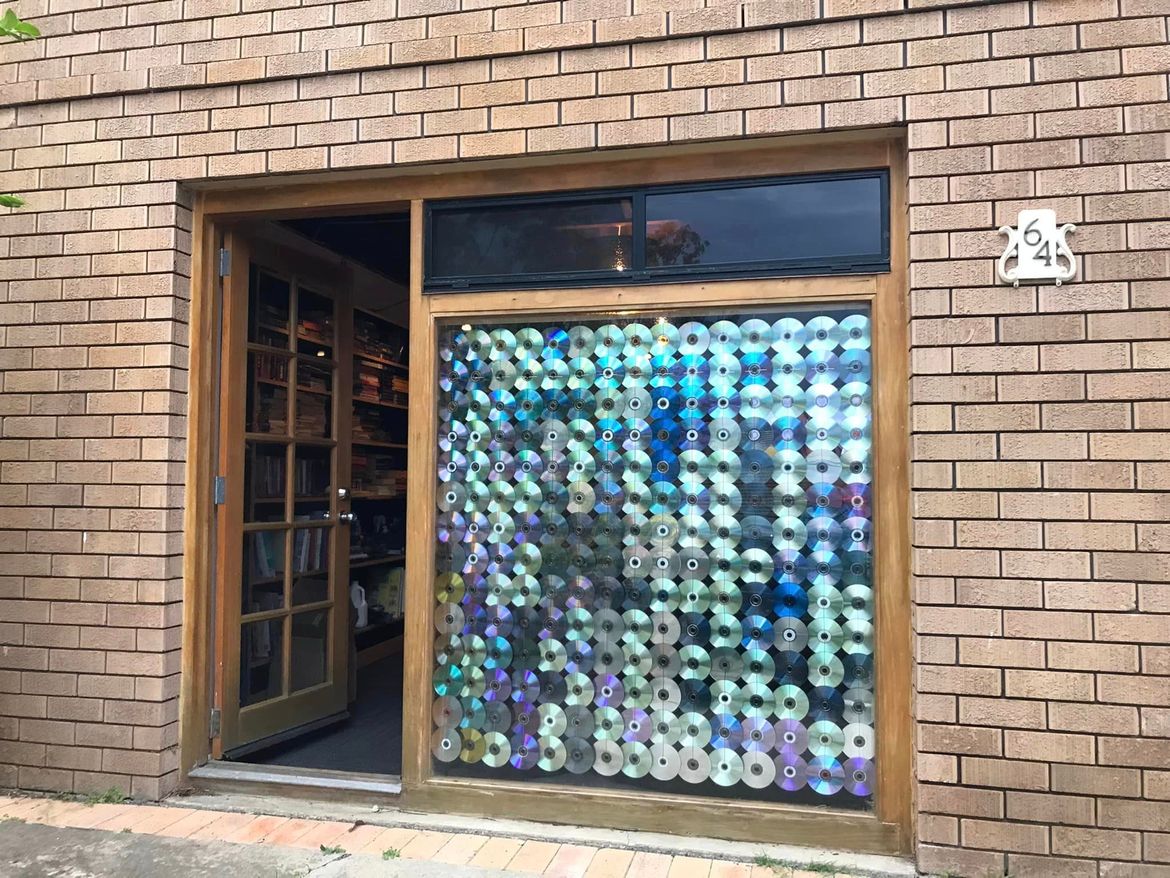

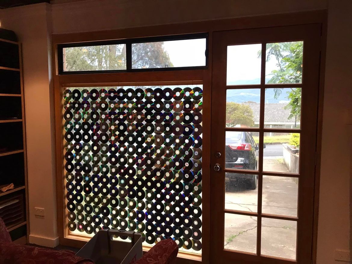

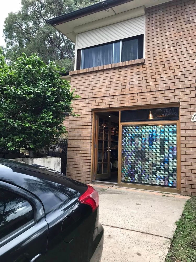

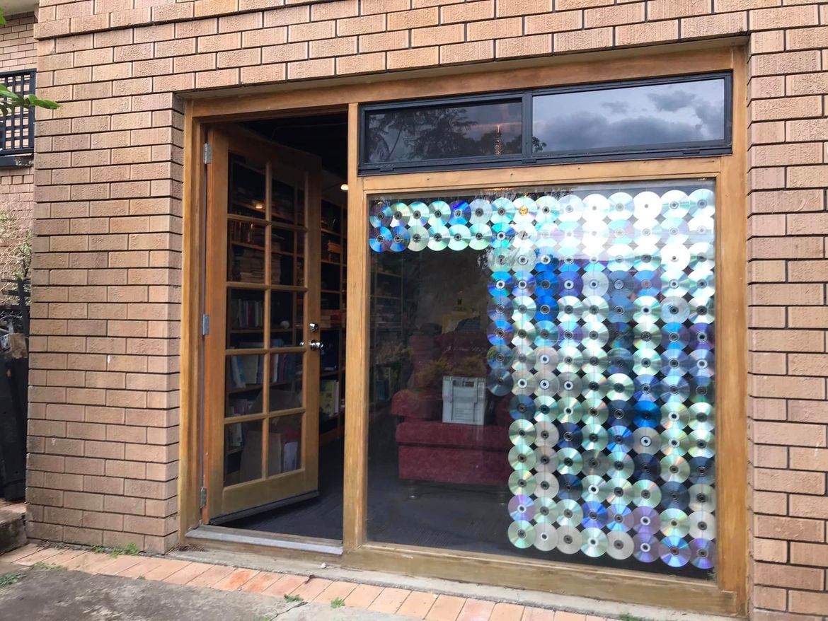

Completed tho static.
It works well. Not quiet as good as the white paper but pretty effective. At night when I reverse up the driveway the colours shine like crazy. The discs do not jiggle when the door opens and closes. I think its because of the double thickness of the discs have some weight to them. I was going to have a tie wire across the bottom but never got around to it.
I am happy with how it works. Definitely up for ideas on how I could raise it (I have considered rails to slide segments across but was after the whole window pane being able to be looked out of.)
