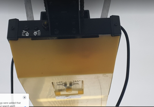

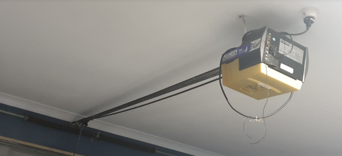

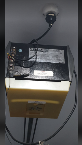

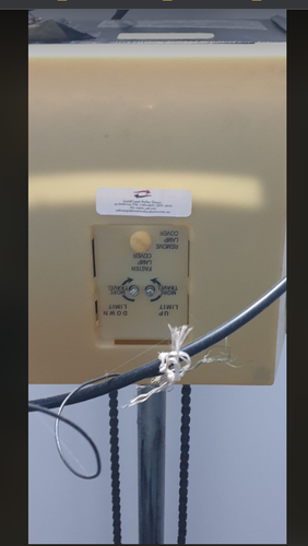

I have Merlin Model M-230T installed in my garage door. It looks like an older model.
Since I have noticed that my garage door opens automatically ( without me pressing the garage remote button) now and then, sometime in the middle of the night and sometime in the middle of the day, I am a little bit worried about security.
What could be the reason ( if anybody has experienced this situation before)?

Thank you for sharing your question about remotely controlling your garage door. Before I make my suggestions, I recommend having your garage motor and electronics serviced as there might be an existing fault in the system causing it to close and open at odd hours. It might also be the remote itself and is malfunctioning.
At the back of your garage motor is the big Merlin sticker and below this is the tag of the service agent that installed the unit. I propose giving them a call and seeing if they can still service your garage motor and remote. If not, I suggest calling Merlin and seeing who is the closest service agent in your area.

The strange thing about these door openers (I have one myself) is that the signal from the remote to the unit uses a frequency of about 433- 435 MHz.
Now, that wouldn't normally be an issue, but since these units were designed and installed in garages, all sorts of other things have been added to this range of frequencies, namely baby monitors, some types of walkie-talkies,  wireless weather stations also transmit data over this band, this is not an exhaustive list.
I'm an Amateur radio operator and I have to power my door unit down if I'm using the 70cm band or all hell breaks loose if I don't, these things are very susceptible to stray RF currents.
By all means, let us know how you get on, because to be fair, I haven't sorted my one out either.
