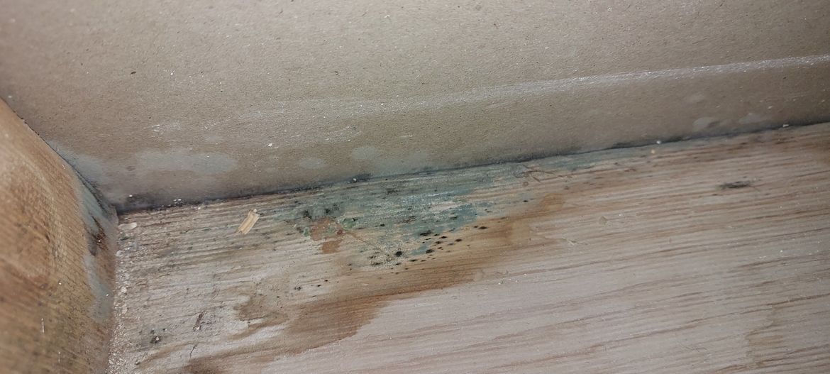

Studs and wall is dry but I see mould. Is there any way to treat/kill it?
Thanks
Re: Dehumidifier rent or buy for mild water damage
Hello @legopoint
I suggest using Intergrain 800g Ultraprep Mould Killer. It effectively kills and removes mould and is specially formulated for use on timber, plus it's biodegradable. Please note that this product is a concentrate and needs to be diluted in water.
Please remember to wear personal protection such as gloves, goggles and a mask when using this product. Please make sure to follow the mixing directions and to take all the safety precautions printed at the back of the container.
Thanks @EricL
Above product is for external timber but the mould is on timber inside the wall.
In "You might also like", https://www.bunnings.com.au/concrobium-946ml-mould-cleaner_p4460772  was listed which looked promising from the description but it has mixed reviews.
Re: Should I rent or buy a dehumidifier for mild water damage?
Hi @legopoint,
Using Selleys 750ml Rapid Mould Killer Remover would be an option. The application steps don't mention timber, but as long as it contacts the mould, it will be effective. Alternatively, you could mix up a solution of one part bleach and two parts water. Spritz the areas with the solution, and it will kill the mould spores.
Thanks @MitchellMc
I'll try bleach idea first.
