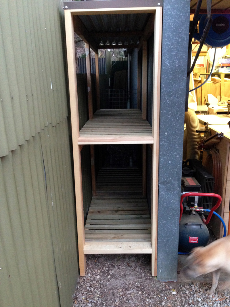

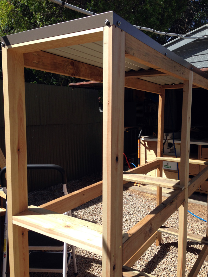

I ahd a wasted area between the shed and the fence and decided to make a simple structure to house some timber.Constructed with a combination of new and reclaimed 90 x 35 framing studs assembled with glue and screws and pocket hole screws.I added a sheet of fencing corrugated iron as the roof with some flashing all round and a slope to the back for run off.Once it was in position I crawled in and nailed permapine slats on the two levels.Another project finished and utilisation of an unused wasted space.
@Wayne
Great utilisation of space, but stock it up quick, or you might lose out to the interested party in pic #3. : )
It got full pretty quick, unfortunately Abbey (the interested party) the little Shar Pei we had for 16 years passed away about 10 months ago.
