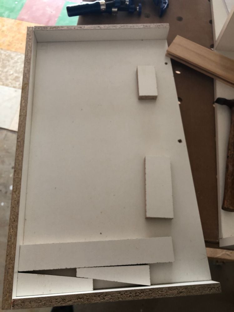

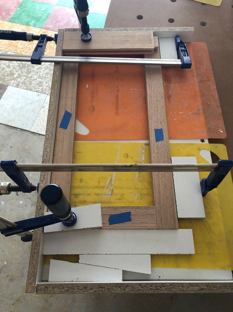

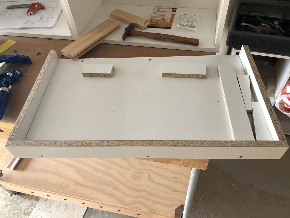

I  had to glue some cupboard doors for an overhead cupboard I'm making, I could never get the frames perfectly square, so I decided to make this jig to hold the the doors in place whilst gluing them. It was quite simple to make, all I did was use some squared off melamine and screwed timber edges to three sides, hopefully others could use this idea, when trying to glue timber at 90 degree square.
I only glued one end, I need to slide a glass panel in before gluing the other end, still waiting for the glass to arrive.
