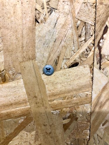

We have lined our workshop wall with OSB brace board to provide a bit of a sound barrier for our neighbours when using loud tools and machinery and because we think it is a little bit more aesthetically pleasing.
What we used:
We started by filling between the purlins with the earth wool insulation. This stuff is pretty nasty to work with so make sure you're wearing long sleeves, pants, gloves, safety glasses and a mask.
We were lucky that the distance between each of the verticals is 2400, which meant we were able to fit two brace boards side by side without cutting with a butt join in the middle. If the boards needed to be trimmed we would ensure the original edges were used to form the butt join. We decided to use wafer head screws to avoid the screws pulling through the board.
We found this quite a simple project and feel like it has transformed the original workshop wall.
