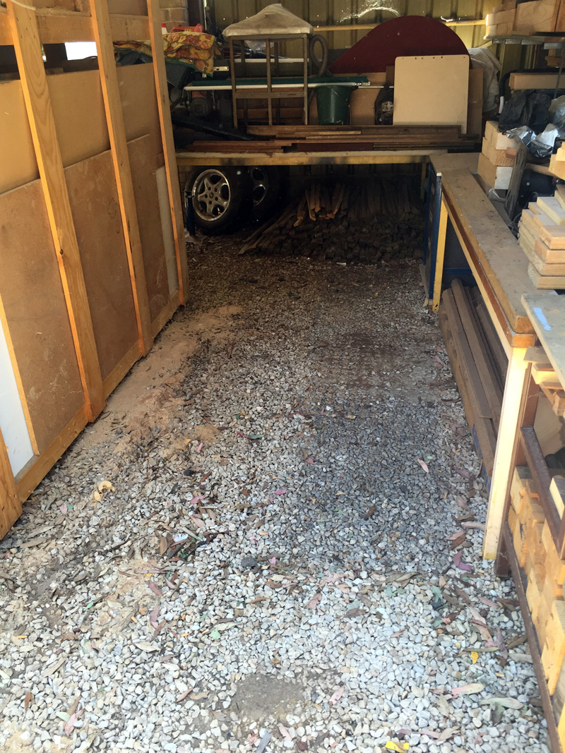

My workshop (Shed) is very small (6m x 4m) so I wanted to make use of a covered area which is a side extension of an under main roof carport.
I was using the area for my Sliding Mitre Saw station but it only has a gravel surface, so I decided to make a floor for it.

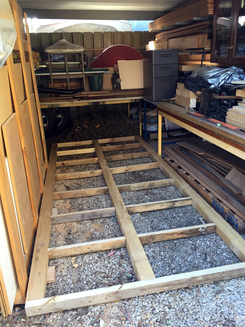

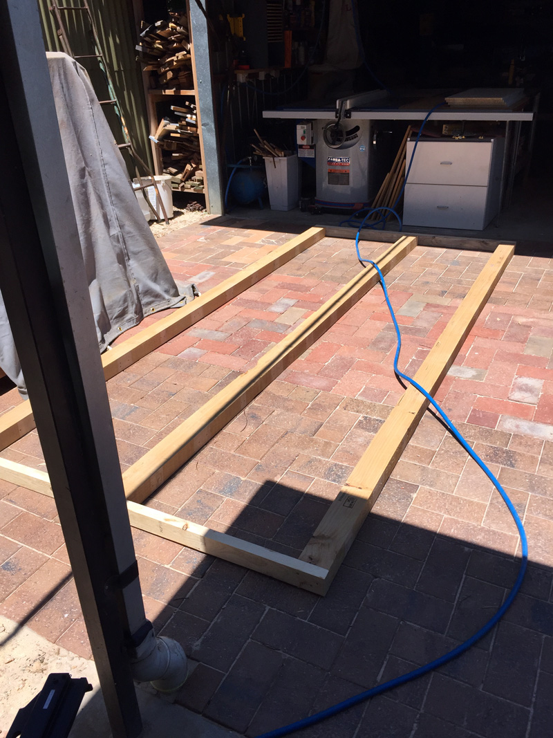

A local business was clearing large 3.6m Pallets so I collected one of those and used the 90mm x90mm stretchers to create the floor frame.
I nailed in a number of cross supports using other salvaged timber and positioned and leveled the floor frame in place.

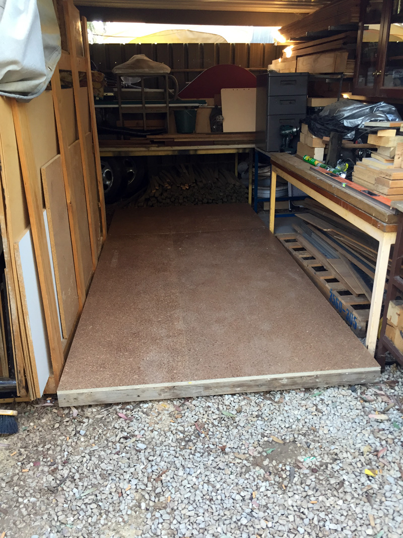

I went to my local Bunnings and bought 2 sheets of Yellow Tongue Constructor Foor and had them cut it to size so that it fitted perfectly, then screwed it down to the frame.

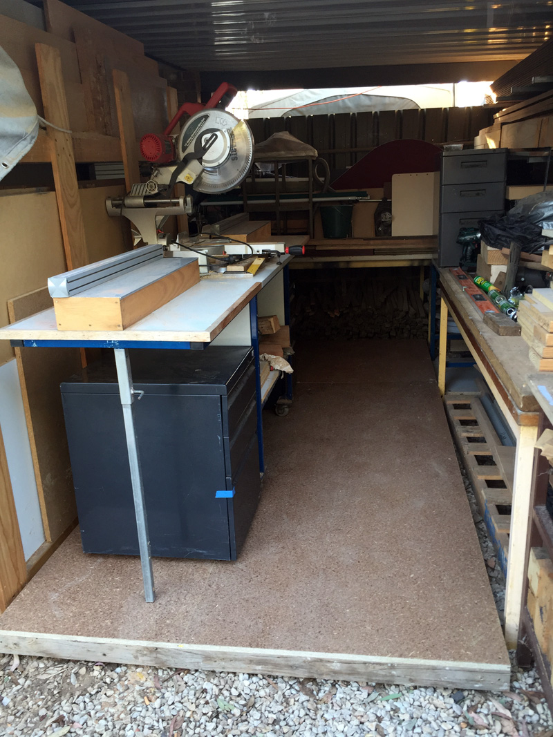

All done and a lot more comfortable on my feet when wearing my safety slippers!
I have since covered the remaining gravel area with sawdust for even greater comfort.
