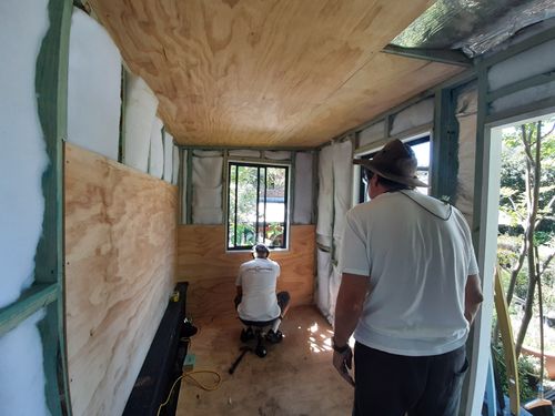

Hi all,
Just finished lining my SheShed with 7mm bracing ply (cheap&easy) but of course it does make me feel like I'm in a big packing crate 😬. Don't want to just paint it all in regular white paint, I was thinking to whitewash/limewash it to lighten up all the timber but still keep it a bit rustic. Has anyone whitewashed timber ply before? If so, any tips? Thanks in advance. Here's the ply going on...shed is 3.3 x1.8 x 2.3high, 4 windows so good light
We did it with watered down paint. One person rolled the paint on while the other wiped it off with a rag. We did a light coat first and ended up doing a second to darken the colour. We sealed it with a clear coat for protection not needed but as an art studio helps with cleaning. Do small sections at a time so it doesnt dry off.
