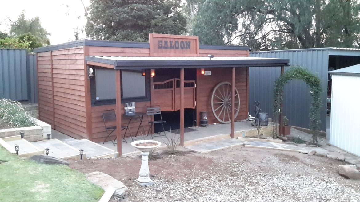

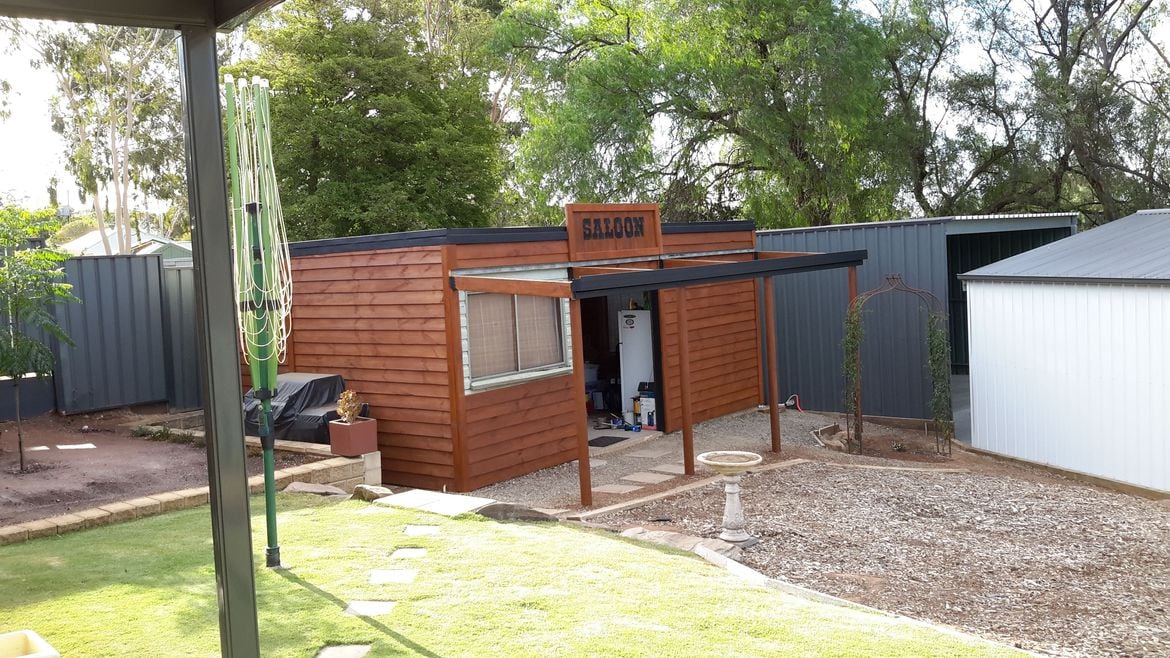

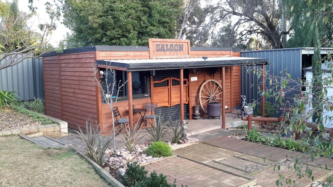

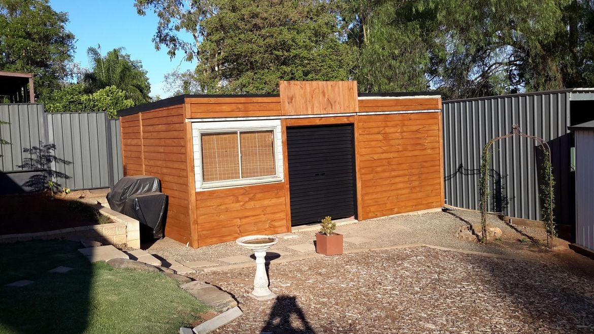

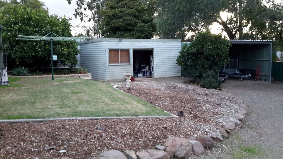

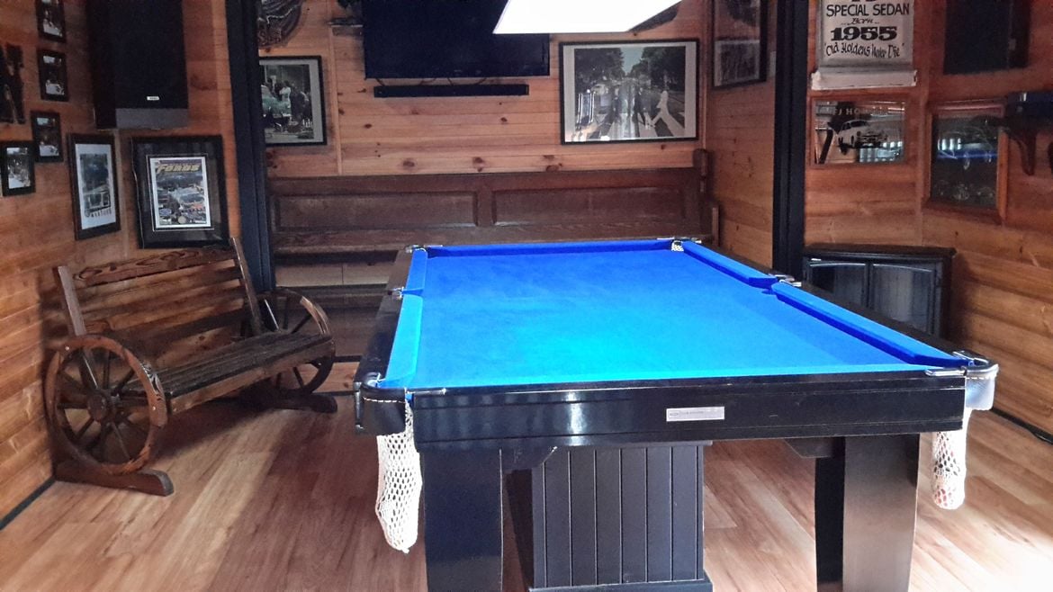

Hi, bought our place in Gawler in 2018 and it had a old green weatherboard shed in the yard. we used it for storage until deciding what we could do with it. we turned it into an old western saloon, unfortunately we are unable to download more pictures which would give real understanding of what we have started with and the final outcome. Just about everything we have done with this shed has been obtained from Bunnings.
Materials
Perma pine pailings ext
perma pine posts ext
Taubmans chestnut stain ext
V board interior lining
Laminate floors int
the list goes on etc
Tools
Nail gun
drills
impact drills
reciprocating saw
circular saw
paint brushes
Steps
Step 1
1 clean all the walls and have them free ready to panel with the perma pine pailings which we nail gunned and screwed into positiion
Step 2
2 stained all the walls to make it look old school, saloon rustic
Step 3
3 took the old verandah off the back of our home and cut it down to size and put it on the front of the shed
Step 4
4 Next we recycled the pavers from the rear of the house and used those for the path across the front of the saloon and made the steps leading to the saloon out of pine sleepers and recycled pavers
Step 5

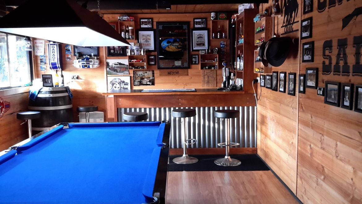

5 we then lined the walls with v board which we lightly stained, we did the ceiling in perma pine pailings and stained to match the exterior. we built the bar out of recycled timbers and used iron.
Step 6
6 dressed the walls with shelves which are cut down wine boxes and the floors are timber laminate.
Step 7
7 We called our saloon the One Shot Saloon as life can be just that if you dont make the most of it.
