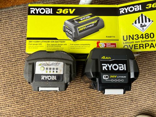

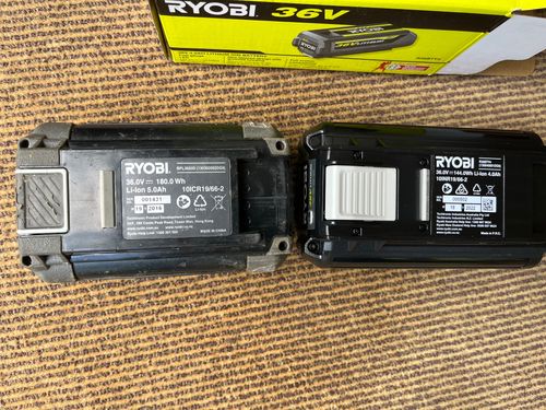

I'll contact Ryobi on Monday to see if they can shed any light on the issue @glenn3676. In the meantime, would you mind sharing an image of the two batteries side-by-side? I'm wondering whether there has been a style change on the new batteries that stops them slotting into the old mower correctly.
Hi Mitchell thanks for the reply. I did
contact Ryobi a few days ago but too early for a reply. The batteries look identical to me. I took pictures of the mower contacts. The yellow picture is the not self powdered one 2.6 Amp battery, the other one self powered 5 amp battery. The contacts on the mower are one far left one far right and one third in from the right, they are the same on both mowers. It can only be either a change in a 2014 battery to a 2018 battery, or the 2018 battery for whatever reason is not making all three contacts. I just want to buy a new battery 4 amp but now I am unsure if it will work in the smaller older mower that's my issue.

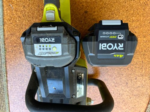

Hi, I can confirm that statement is incorrect. I have a Ryobi 36v mower. I recently bought a 6AH battery to use and it will not fit, despite being told it would. The plastic cover on my mower is fixed at all 4 corners and is simply too low for the added height of the 6AH battery.
just in case anyone else decides to embark down this path, the 5ah battery is the largest for the first 36v mower Ryobi created and sold.

Hi Eric, the mower is a Ryobi RLM36. It’s a 36v, not a One+ (The model has nothing after 36, it is the very first 36v I believe)the battery fitment for contacts etc are identical. The only way to tell if the battery would have fitted was to do what I did, or to take the mower in.

i’m not sure that compatibility is always their strong point, to be honest. I have a collection of Ryobi 36V brushless tools, bought exactly for the reason of battery interchangeability. They have worked well for several years with the original 5Ah battery that came with the mower. The battery has now died on me and Bunnings tell me that Ryobi now only supply 4Ah or 6Ah batteries. They didn’t seem an issue, so I paid my $260 for the 4Ah one, only to find that some silly designer has changed the rounded shape of the plastic case in favour of a more angular one, and it doesn’t fit into the enclosed battery compartment on my chainsaw (an RCS36B35)!! It seems to fit the other tools, which have open battery mounts.
H
ow do you suggest that I repower my currently unusable chainsaw? It would be ludicrous and very eco-unfriendly to throw it out for want of a compatible battery!

The Ryobi RCS36B35 chain saw came out in 2014 and came with a 36V 5 amp battery. As time moves forward updates on cordless tools are inevitable, some products are superseded and others stop production altogether. I understand that your chainsaw has given you years of reliable service, unfortunately, time has caught up with it. Ryobi has stopped the production of the 36V 5amp battery and the new battery system is no longer compatible with it.
Your chainsaw does not have to end up in the bin. There are other avenues to give your chainsaw a second life. You can sell it at the second-hand market, there are those chain saw owners who have damaged their saws, but still have viable batteries. You can donate it to the Man Shed or a similar charitable institution.
The good news is that Ryobi has progressed from this chainsaw design issue with the 36V battery and has made it into an open-type system as well. You can see a very good example of this on the Ryobi 36V 35cm Brushless Cordless Chainsaw - Skin Only.
