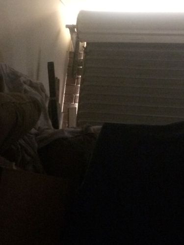

What can i use to seal the sides of the garage (on inside)?
bunlovers
Junior Contributor
Need to seal the sides up   what product from bunnings can i use ??

I take it you use the roll-a-door? And are you referring to a gap between the bricks and the wall or between the roll-a-door and the bricks?
Re: What can i use to seal the sides of the garage (on inside)?
Hi @bunlovers. Hope you are travelling well.
Have you had any luck with sealing the gaps on the side of your garage? The spaces down the brickwork where the light is coming in are gaps between the running channel and the contours of the bricks. You can fill these gaps with a bead of Sikaflex 11fc which is a polyurethane adhesive sealant. It is specifically formulated to adhere to masonry and steel, providing a flexible bond in situations where movement is prone.
